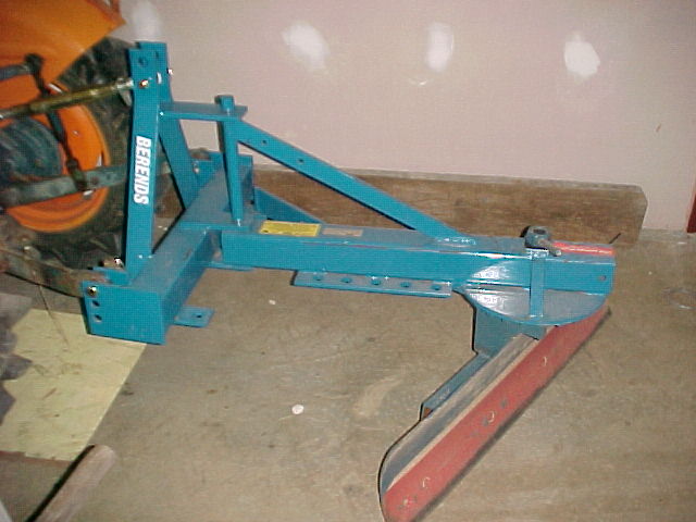

Well after much reading on TBN I decided to buy my first NEW implement. Try and keep the $ down by buying old stuff but hard to get exactly what you want.
Ended up with a 4' rear blade for my little Kubota. Picked it up today.
Spent about 2 hrs with it this afternoon. I was surprised what I could do with it in that time.
Made a hell of a mess of some of the "speedbumps" in my driveway but did manage to cut some new drainage ditches.
I know as soon as I get rain I'll end up with a muddy mess, but if I play around now and get some granite over the top one day, I should be OK.
Will be fun to experiment with it. Had 360 degree rotation, offset and tile so will be very useful. Seeing as I don't have the $ for a loader, this will have to be my "Earthmover" for a while !

Pic attached of the blade too !
