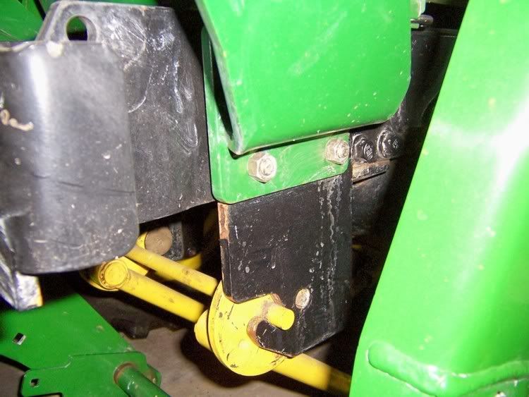

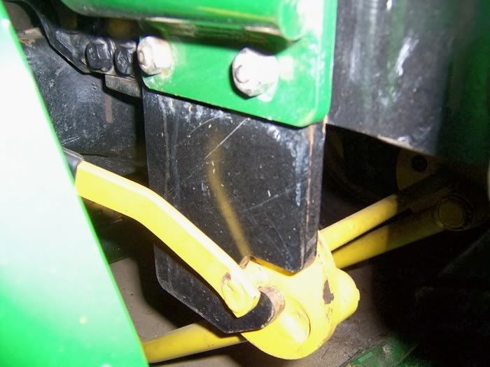

Made a good deal on a 4310, but when I got it home today, I went to put the 72" mmm on and find that I am missing some brackets. Everything seams to be there except for some brackets that apparently bolt to sides of the front frame for the front mower bracket to attach to. Don't know why they would have been removed or what they should look like but something is not there. It will be after the holiday weekend now before I can call the dealer to see if they have them or not.
Can anyone post a pic or diagram from manual of what exactly I am missing? I have the adjustable arms that hook to the deck and curve upwards toward the front frame. Also have the piece that they swivel in that has a handle or lever on it with locking pin. Don't have what it connects to.
This tractor was on their lot since last summer and I doubt very much that they will find them, if they ever had them when they took it in on trade. I really need to get mowing and am willing to build my own brackets if I get an idea of what I need.
Would be greatfull for any help.

If I understand you correctly these are the brackets your referring to.I have a brush guard that bolts over top of them that you may or may not have,and these are on a 4300 but I believe the 4310 is exactly the same.

Lil43---- Perfect pics!!!! thanks

I was cleaning up the photobucket account and accidently deleted images of brackets.Sounds like you dont need anymore but I,ll repost just in case.:eek:
