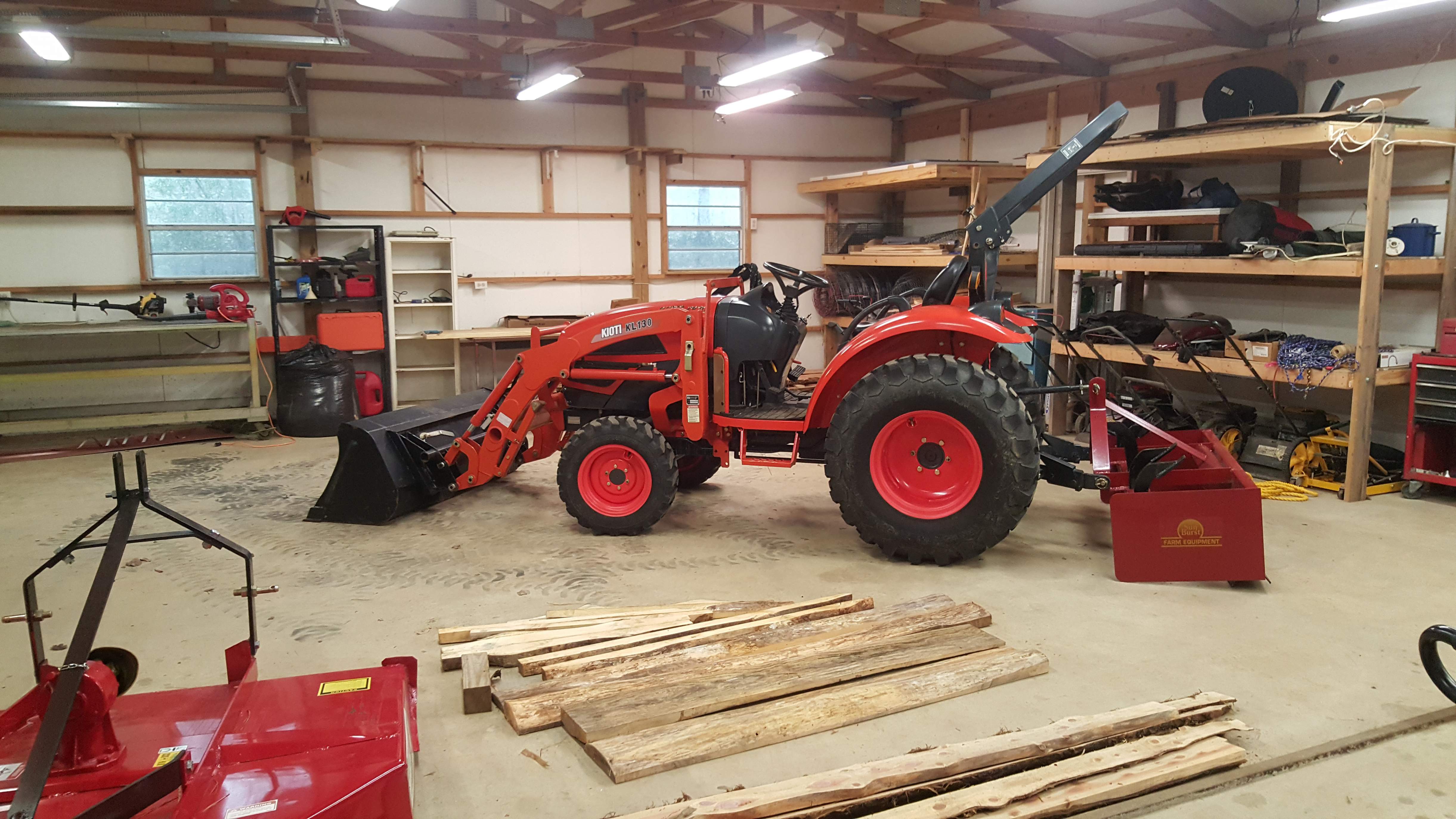

Well, after months of debating, searching and researching I got a new to me 2010 CK30 HST with only 162 hours on it. Only problem is its been to dang wet for me to get it out any do much yet. Y'all got any advice, suggestions, or need to know info I need to know about this lil beast?

I was going to say use the wet weather to organize your shed and make room for more equipment. Then I looked at your photo and at my shop and... never mind.

Nice tractor. Looks brand new. You are going to love it. As with any machine, lubricate everything. If you can't get it out and use it, take the time to put dielectric grease in all the connectors and fluid film/lithium grease any exposed metal couplings. Squirt some fluid film in your key switch too. I also put moth balls under the hood in a perforated baggy to keep the mice out. Enjoy and be safe.

Good looking tractor, implements and storage area. Enjoy. I bought a 2006 CK30 in 2009 with just under 200 hours. Owner before me had taken excellent care of it, well serviced, and I have tried to follow suit. I now have 1219 hours as of today. So handy. Oh, and you probably should grease it. An angle gun will work but you can also get to the underbelly zerks with a flexible hose.
