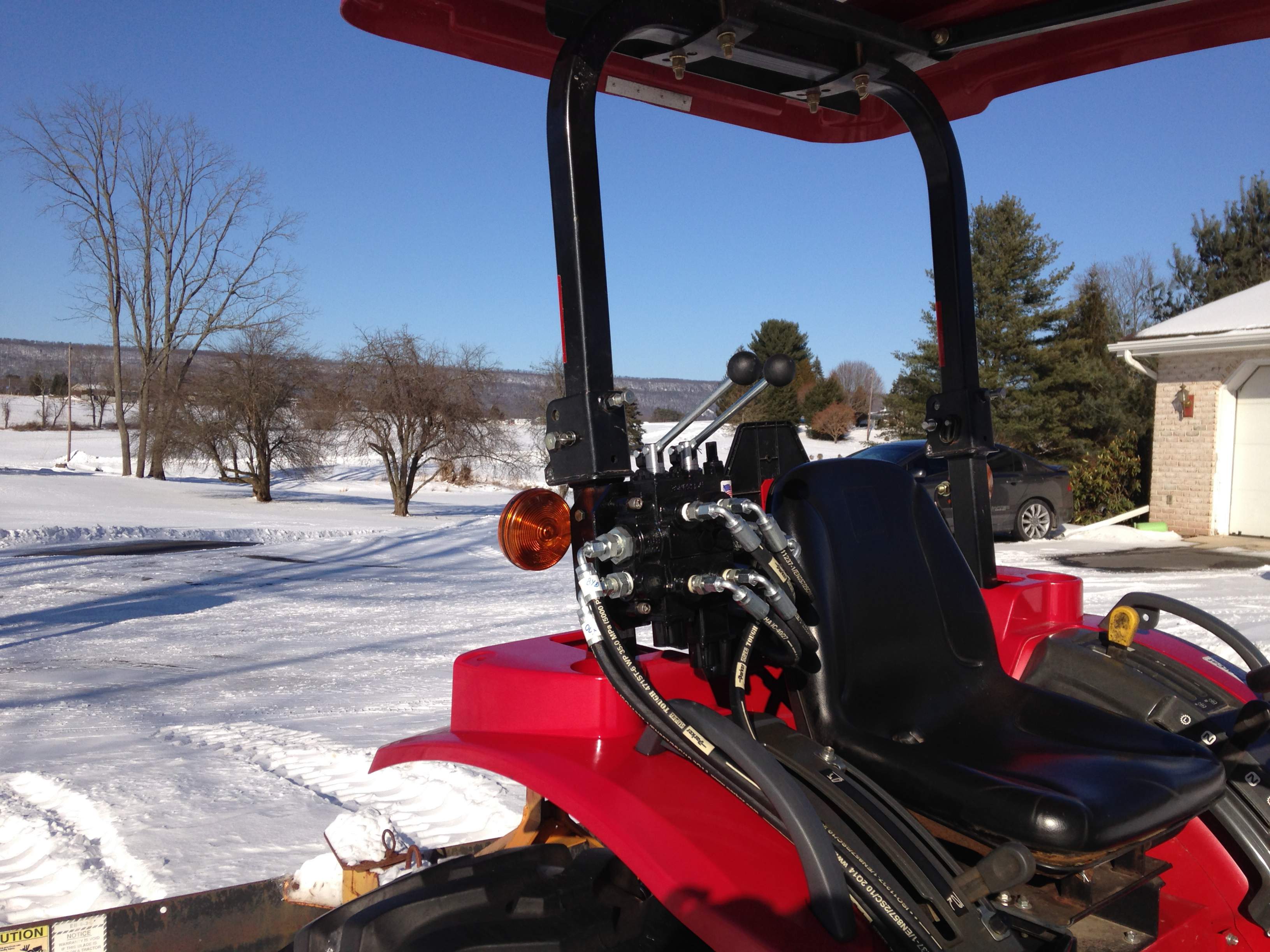

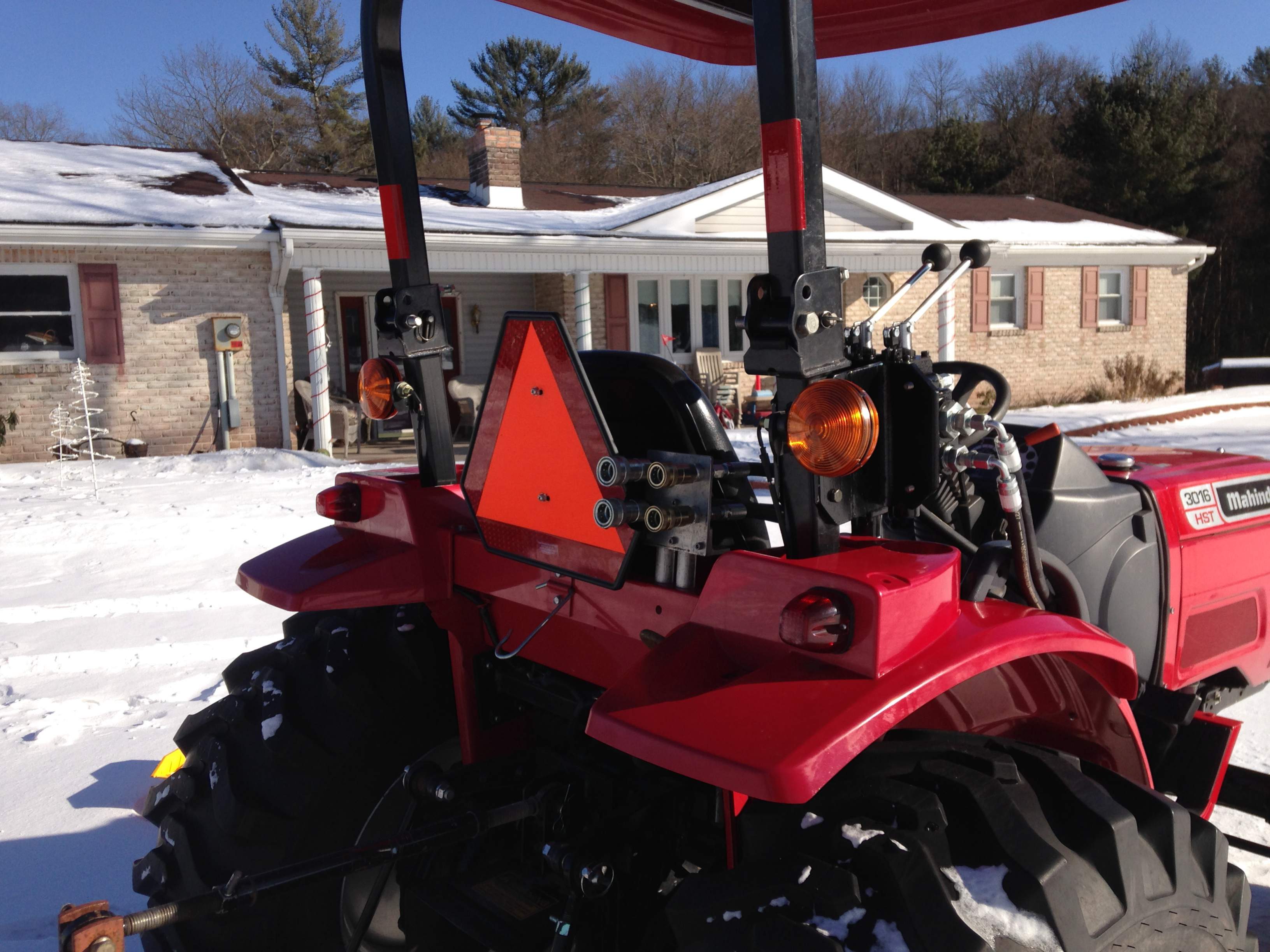

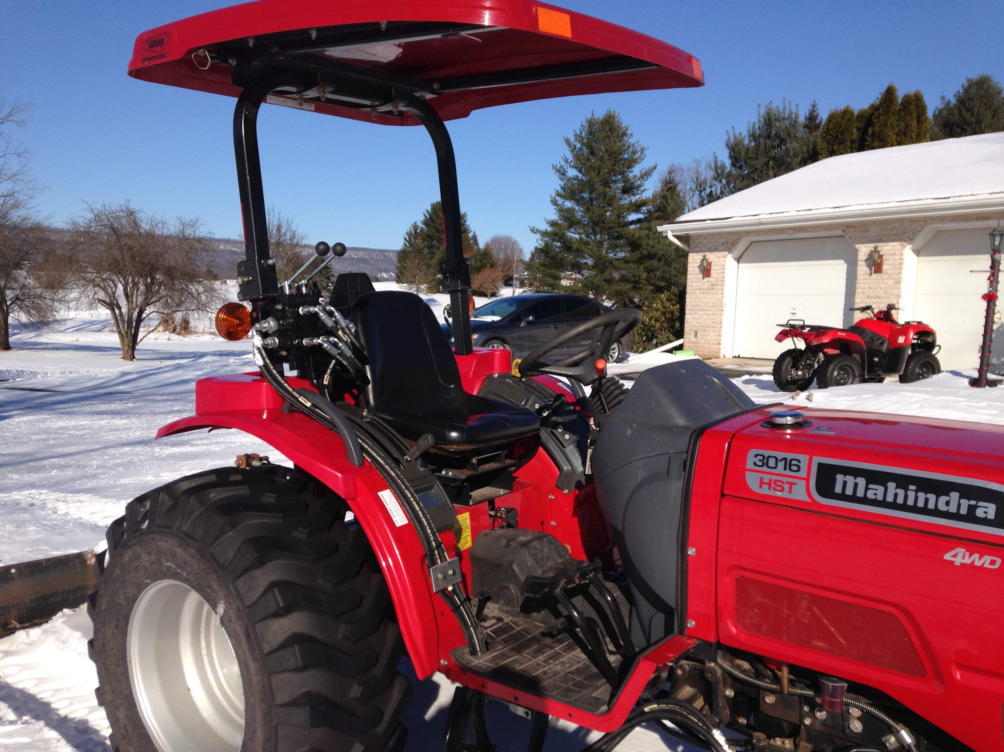

Well, thanks to all for all the advice and help on this project. I learned a lot.
Here's the result.
   / Got 'er done.

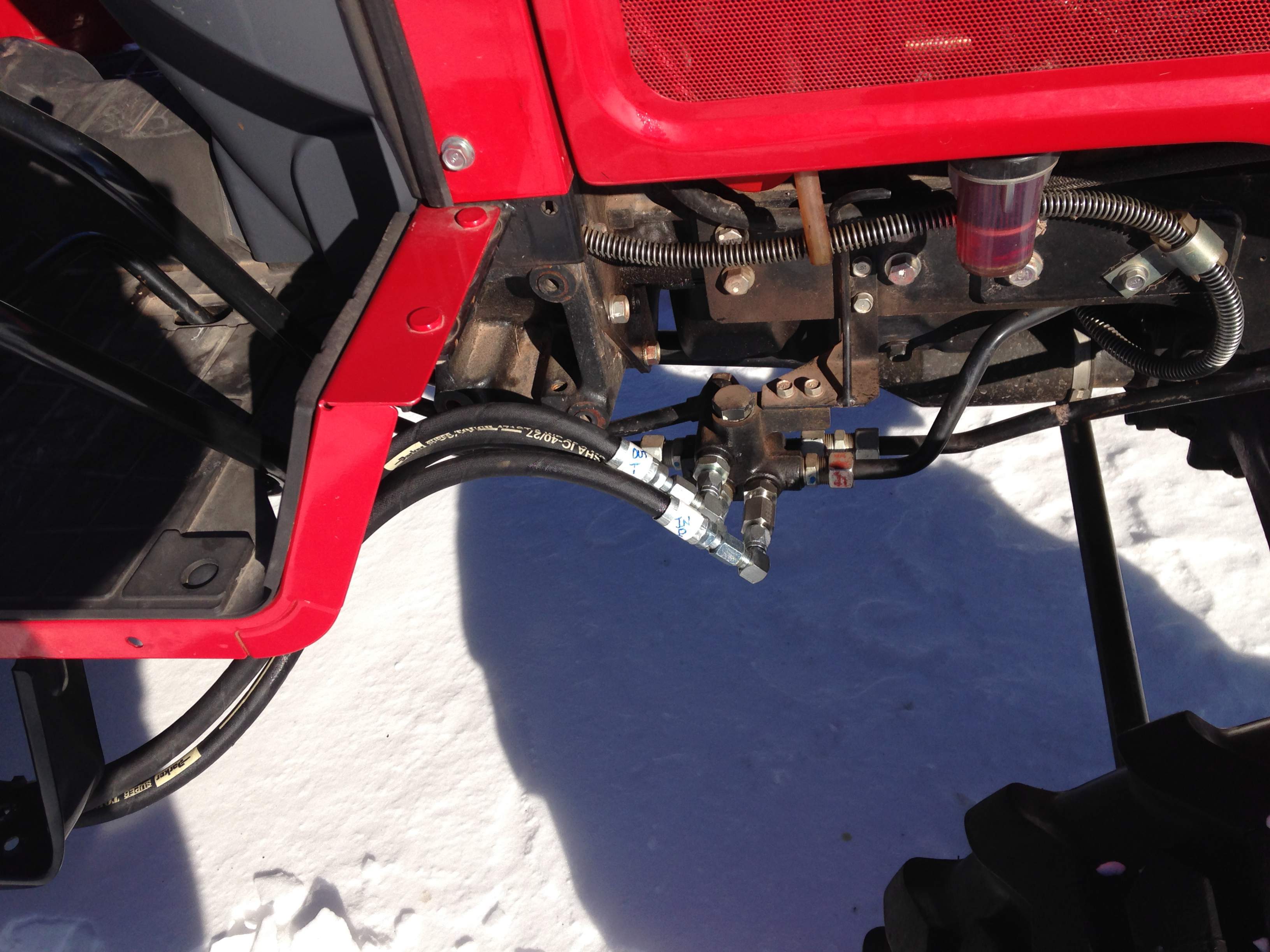

The tractor normally would have an FEL, but I had the dealer remove it as I already have one on my International.
That left the power block open for the connections to my added remotes.
The power block has P, N(PwrByd), and T which are connected to those ports on the valve.

Overall pretty nice job. Good hose routing and looks like good components. The only thing that jumps out to me is it looks like the lower clamp on the fender will eventually wear into the hoses. All I would change is put a piece of rubber between the plate and hoses, maybe add a thin spacer between the hoses and fender to reduce the bend, and make sure the plate doesn't snag your pants if you get off on the right.
Have fun in the snow, I'm jealous!
