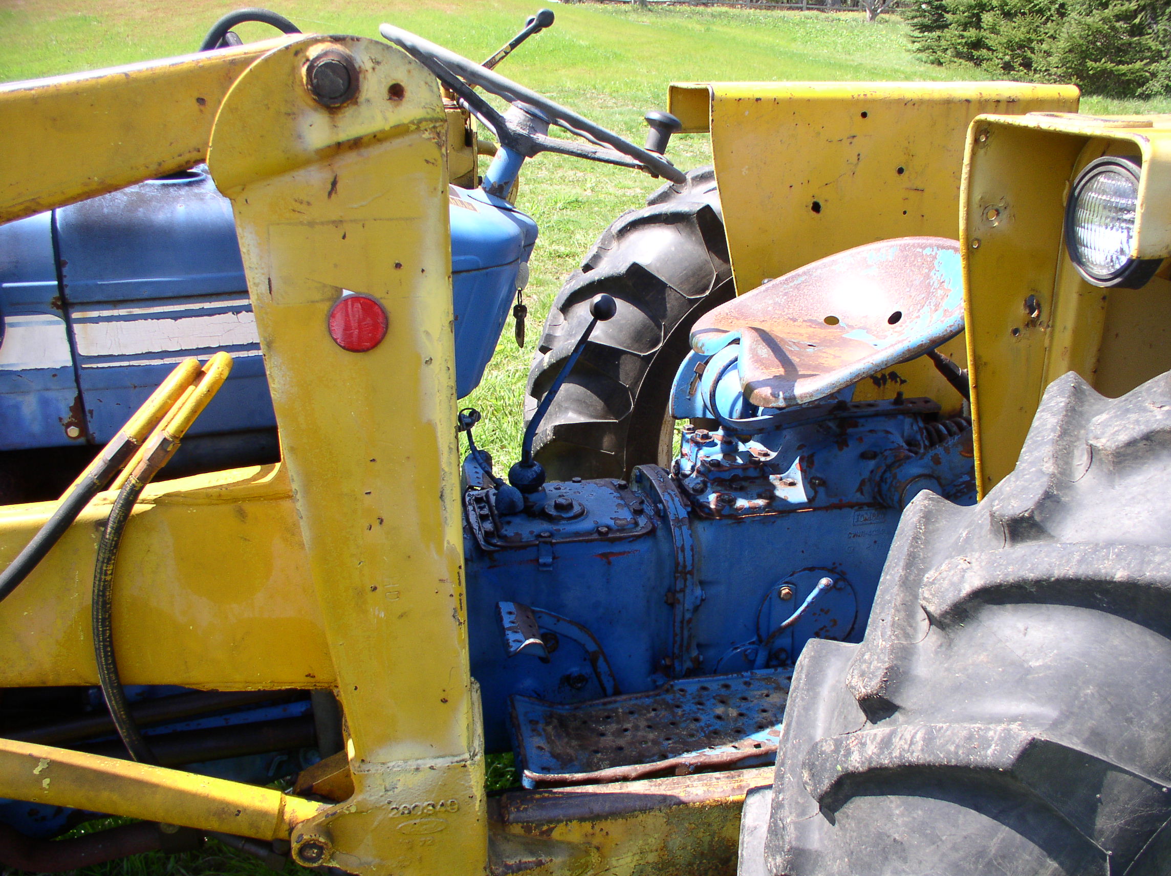

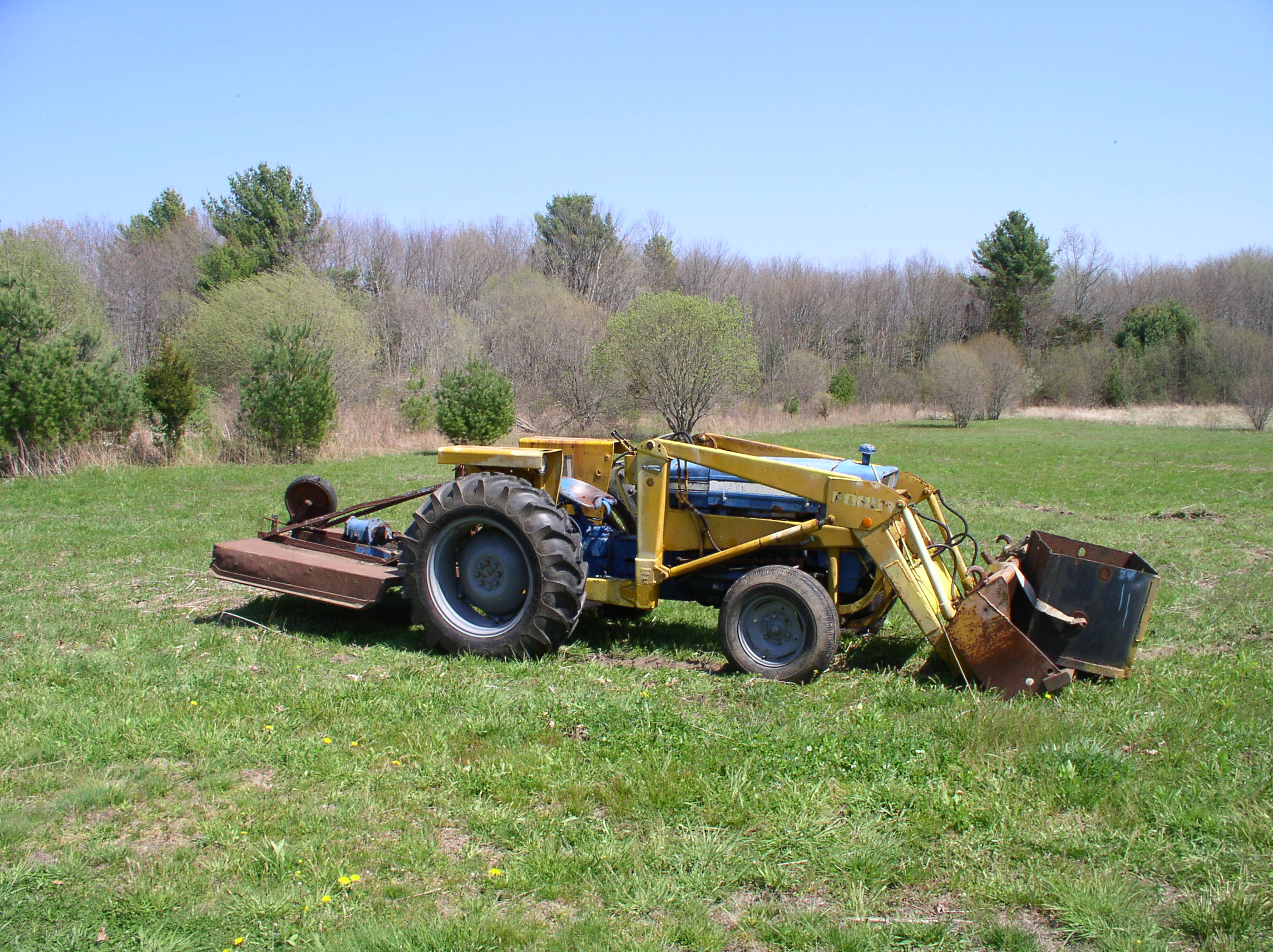

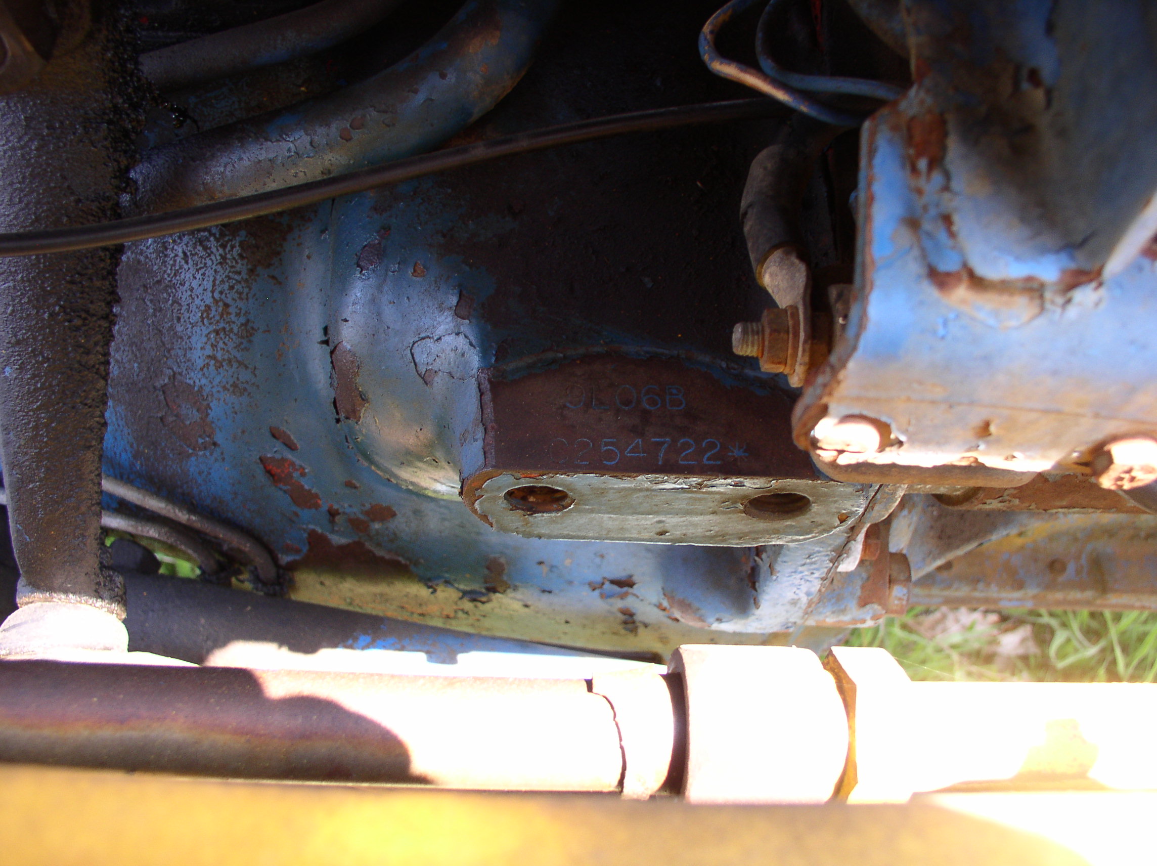

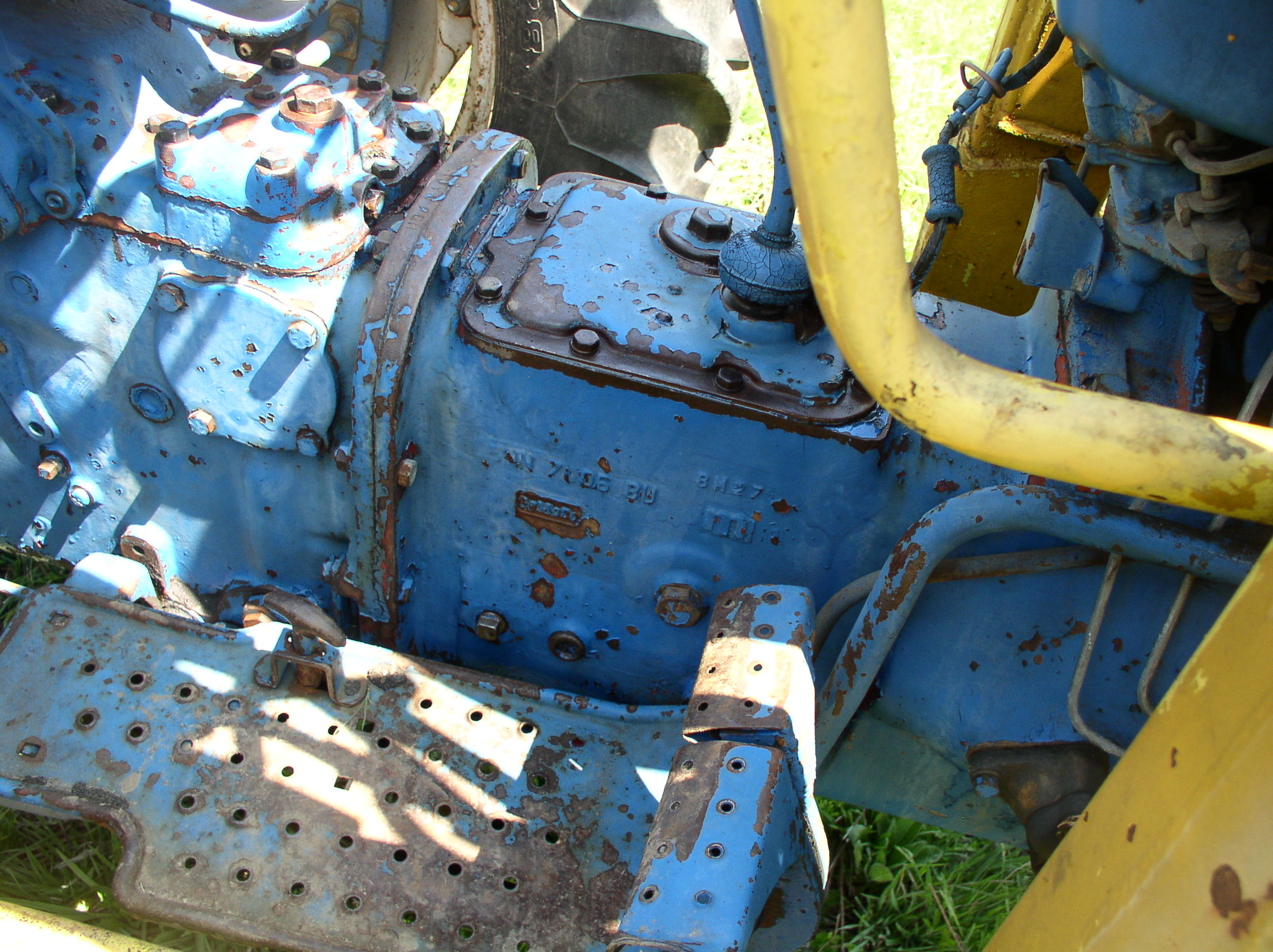

:)Got my first tractor yesterday - 1969 Ford 2000. Paid $2500 for it, including the beat - up but functioning cutter and the weight box. Everything works so far!
Brakes don't seem so good. How do I check them?
What else should I do to it? I'm thinking about hiring a tractor mechanic to check it out and help me do what needs doing. Anyone know one in S.E. Mass.?

Wow. I'd love the loader!

That looks very nice for what you paid! Especially with a loader. Shoot even if it was all junk it was almost worth that much in scrap iron!

Drain and replace all the fluids and check for water in the oil, oil in the water and funny smelling liquids. The transmissions in these old tractors generally have water in the bottom of the case due to leakage at the shift lever boot seal.
Check the entire tractor for fluid leaks. Replace leaking seals.

I cant add much to what others have said. But that is a nice find for the $$$. The tractor alone is probabally worth that without the loader or beat up cutter.
As others have mentioned, check all the fluids. Probabally wouldnt hurt to go ahead and change all the filters AND fluids just for peice of mind.:thumbsup:
Do you know if the rear tires are loaded??? If so that will help with loader work. But regardless, I would figure on leaving that bushhog (or some other heavy implement) on there if you want to be productive at all with the loader.:thumbsup:
