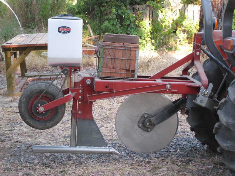

About a year ago I got the only thing that works, so far: a Gopher Getter
GA-400 Gopher Getter

Earlier this summer an old fella (82) stopped by my place and offered to trap gophers for $1 each. He took 190 of them out of my field. I paid him $2 each because he worked so hard. The county pays $2 each as well so he earned $4 a gopher.
About a month ago I rented a gopher getter to pull behind the tractor. It makes gopher tunnels and drops poisoned wheat into the tunnels. The gophers are now under control. Every rain I have 3 - 4 new mounds (on a 10 - 12 acre field) and I trap them out right away. I figure there are very few gophers left and I can handle what remains by trapping.

Do you use the strychnine or Rozol based poison?
I used strychnine bait with good results fall through spring. With summer, I started to have several areas where gophers survived many multiple passes with the machine. I tried Kaput-D Pocket Gopher Bait (Diphacinone), worked great, immediate big difference, no gophers survive.
It might be the type of poison, or just seasonal preference for the grain. Strychnine bait is on milo, Kaput on wheat.
Here's a pic of my Gopher Getter. Coulter is 22":
