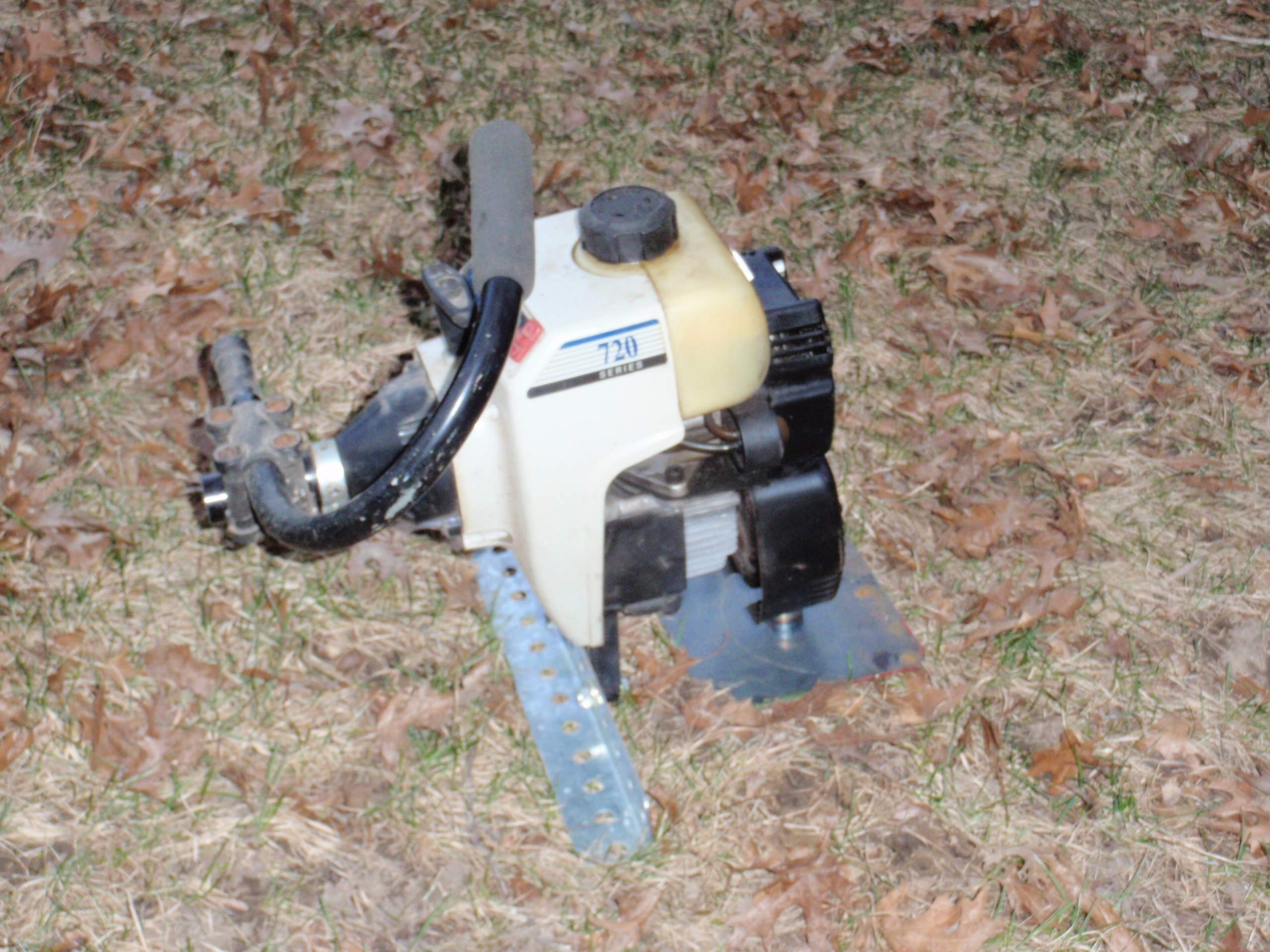

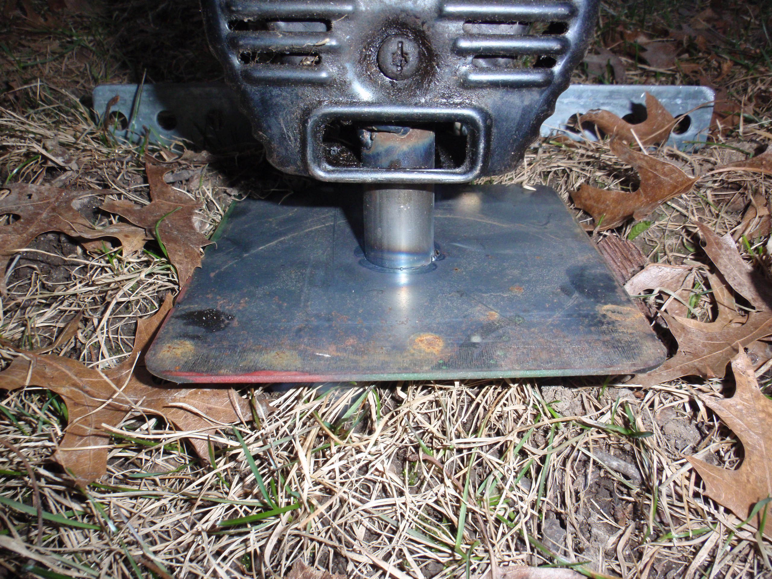

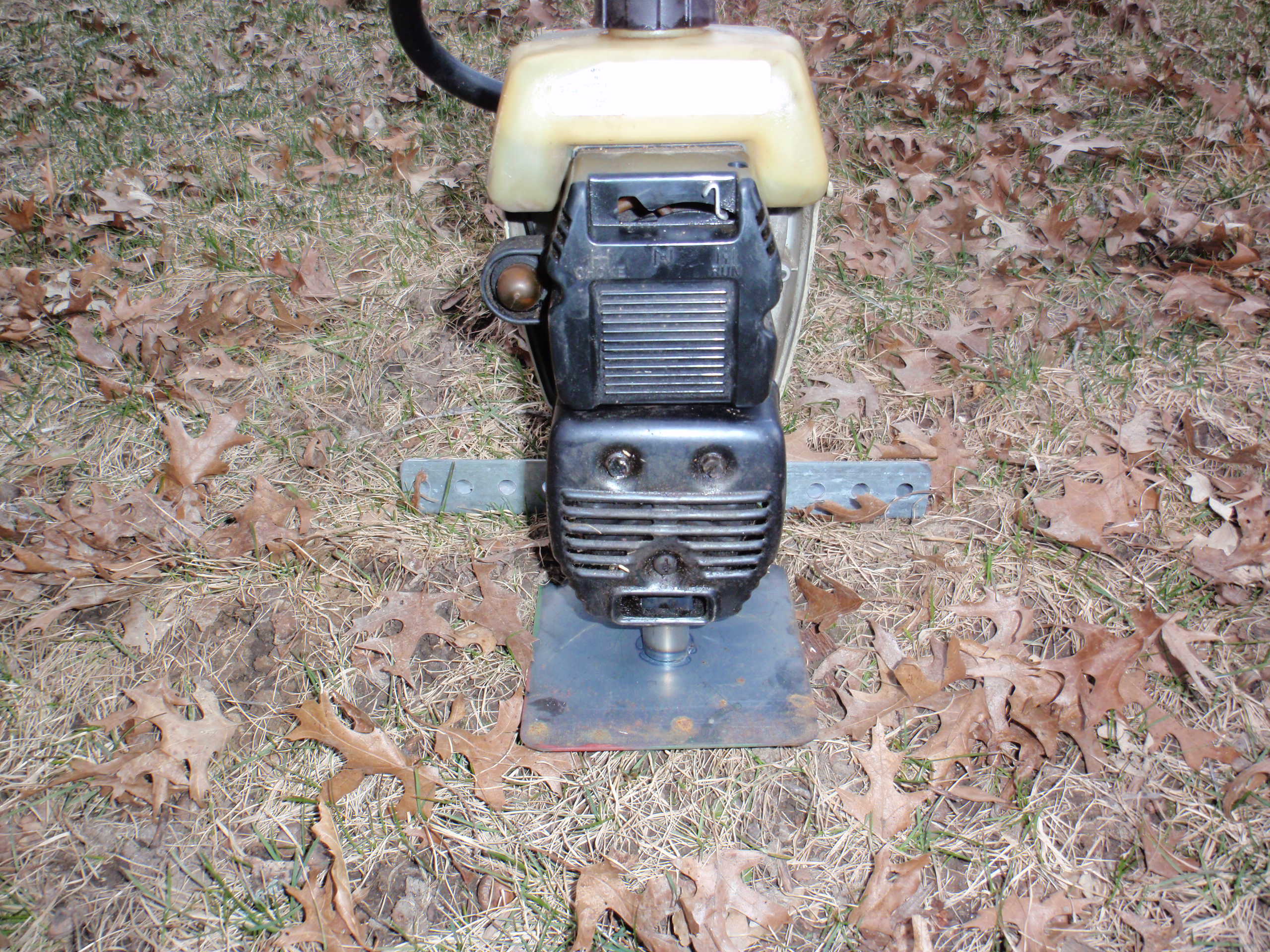

I have read about this, and know a guy who swears by it, so thought I would try it out. Took my oldest crapiest weed wacker and within 1.5 hours I had it ready to try. Pretty simple, just need to weld onto the muffler to get the extension tube to reach into the mole tunnel. The flat plate keeps it from going too deep. The tube extends below the flat plat about 2.5 inches.
I put a video up too, here is the link...
http://videos.tractorbynet.com/video/933/Gopher-Gitter-and-Mole-Muffler

I cannot say for certain yet that it does work. I have a friend that swears by this method, and he mows a multi-strip airfield, so he should know. I used it last night. I found a brand new mole tunnel, and ran to get the "Mole Muffler". I put only about 4-5 ozs of mixed fuel in it, but it ran a long time. The video where I was poking holes in it, was taken right after I started it up, maybe five minutes' run time. It ran for 40 or so after that! If the mole was in there, I am CERTAIN he is dead. I will flatten the tunnel tonight, and watch the area for new activity. Will report back as this progresses.
