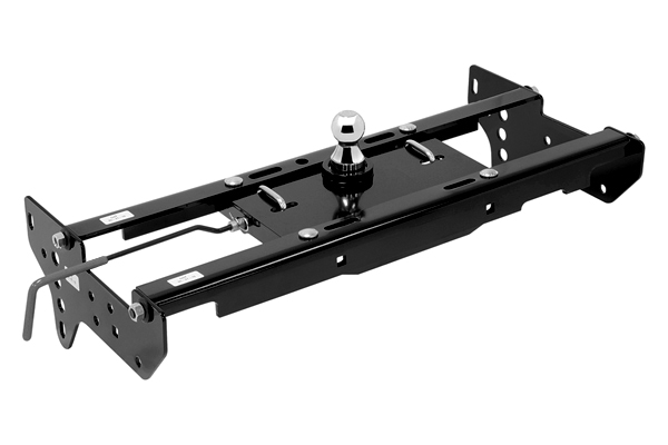

I have a half ton dodge truck with the 5'7" "baby bed" as my dad calls it. What I'm looking to do is put a hidden gooseneck hook up that will not void warranty. Mainly just to pull our trailers out of the field loaded with hay. Very short hauls. We have a 1 ton dodge we use but sure would be nice to have a second truck avaliable. My problem is I found a local dealer that is certified to take care of the warranty issue but when I talked to him he said he wouldn't recommend it for the 5'7" bed. Overall wheel base should be the same as one with the 6' bed so why would there be a stability issue? Granted I have never seen a truck with shorter bed with a gooseneck in person, but I have seen them online. If anyone has some first hand feedback I would greatly appreciate it.

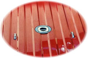

Does B&W make a hitch for your truck? I have one in mine and it is a nice hitch that is easy to install and the ball flips over to leave the bed open. As far as having enough clearance try backing you truck under the gooseneck, at different angles, to where the ball would be and see what it looks like. If you don't have a platform on the goose and just the standard "V" front I think you will be fine with a little common sense when making sharp turns.

If b&w does make a hitch for this model, they also make a insert that has a 4" offset to it, which should help keep the neck out of the cab.

Here is the B&W Turnoverball Hitch: Gooseneck Hitch | B & W Trailer Hitches
And the offset ball.
If you want to pull a horse trailer, you need this.
I have a friend that uses this setup on a 5'5" shortbed. works great.
   / goossneck for half ton truck #8
Looks like B&W part #GNRK1309 fits 09-14 Rams.
