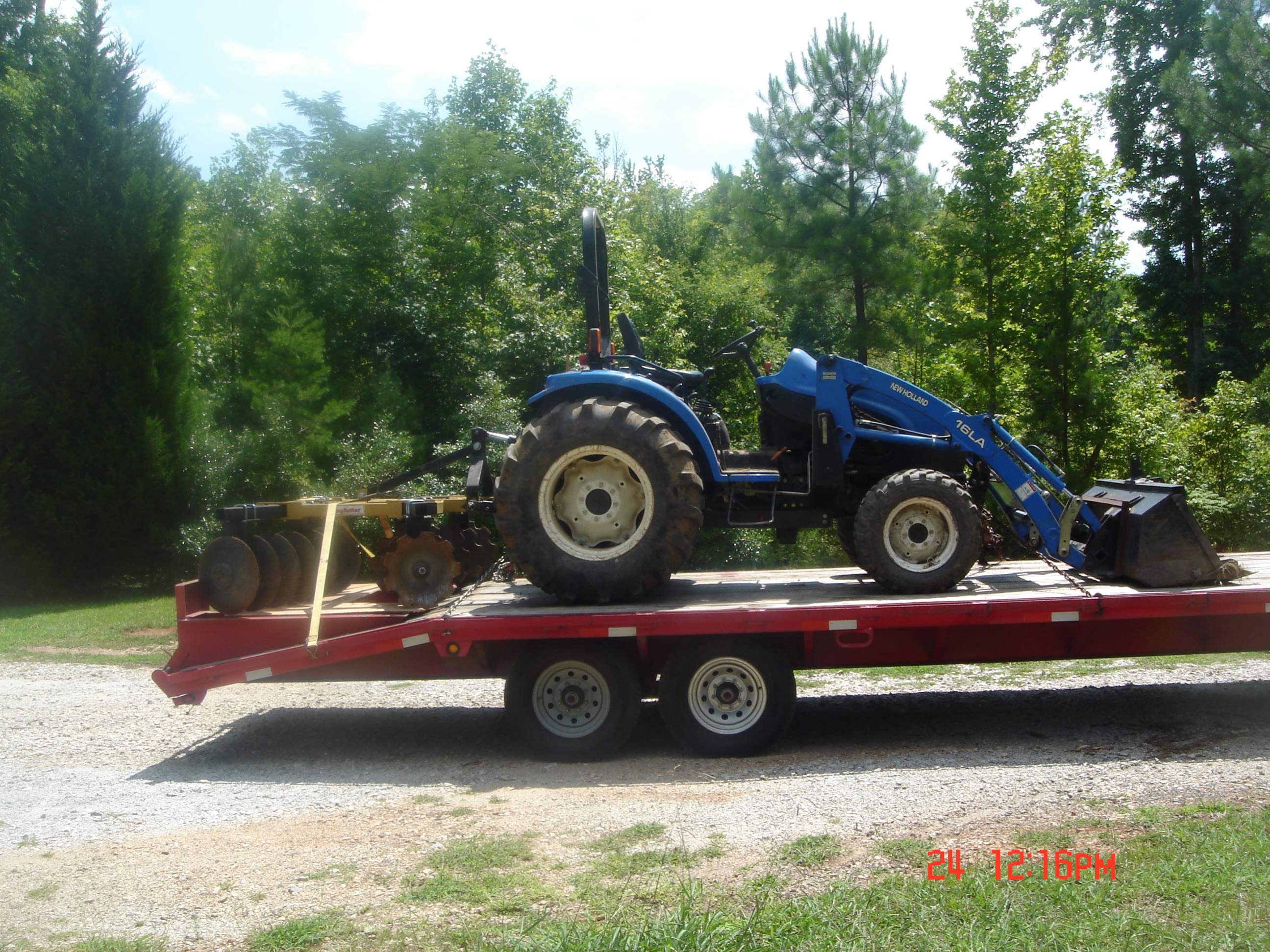

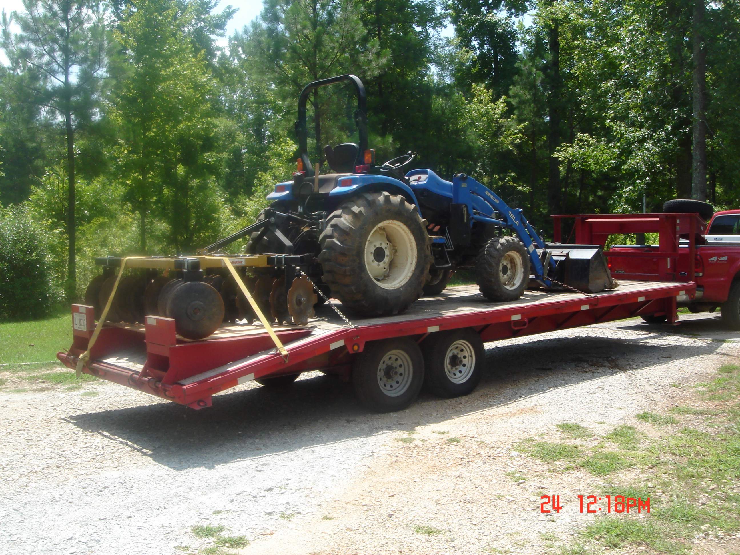

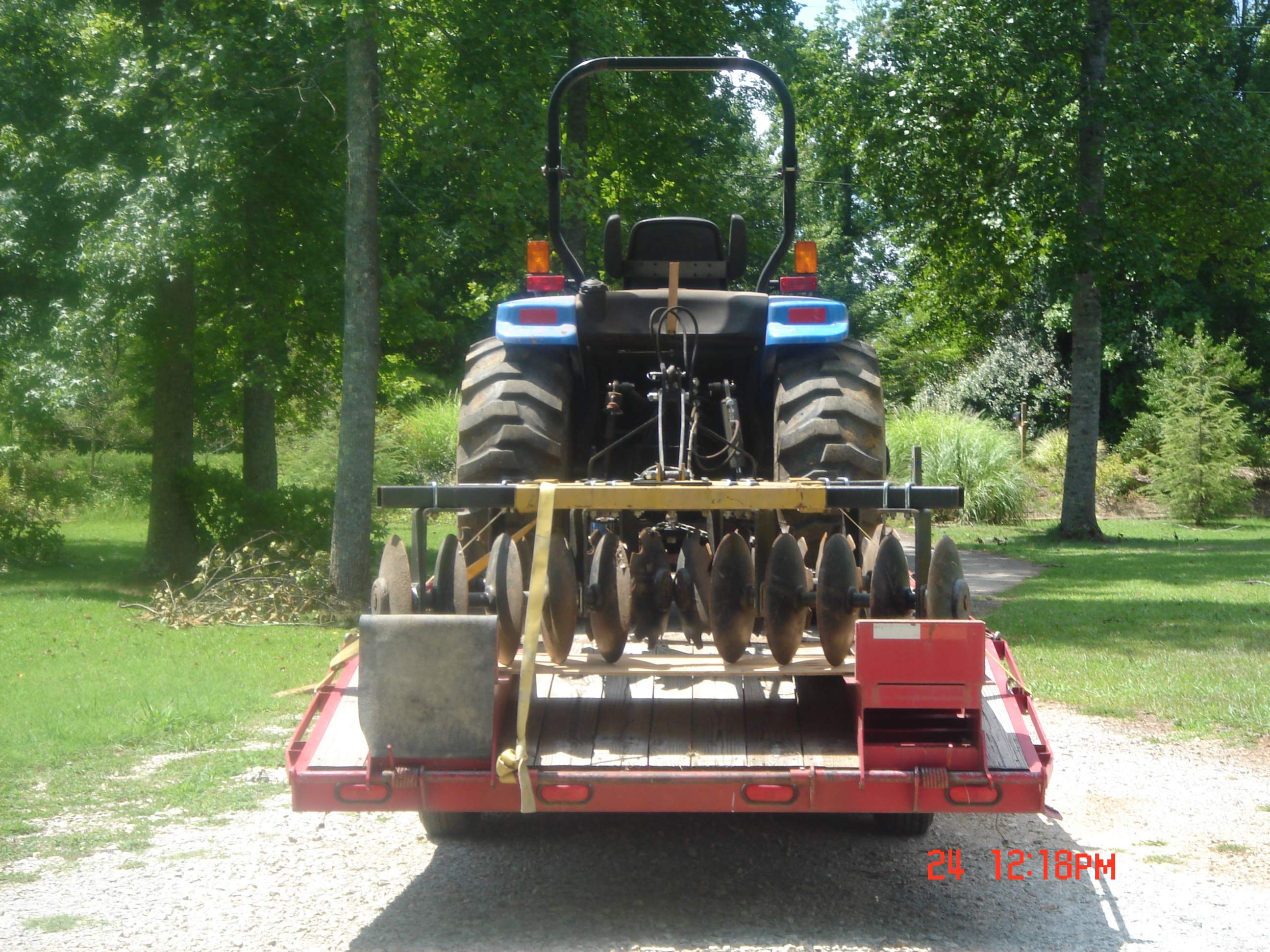

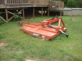

Chris is 100% correct, like usual. I would also go bigger with out any hesitation. Backhoes don't take up allot of deck space. They can be swung to one side to save room. Now a rotary cutter (aka Bush Hog) really eats up deck space. I once owned a Rhino SE-7 rotary cutter that was probably close to 10 ft long counting hitch and the tail wheel. It was always difficult to balance the load on an 18 ft trailer.
What are you towing it with?
Here's a couple of pics of my 20 + 5 GN.

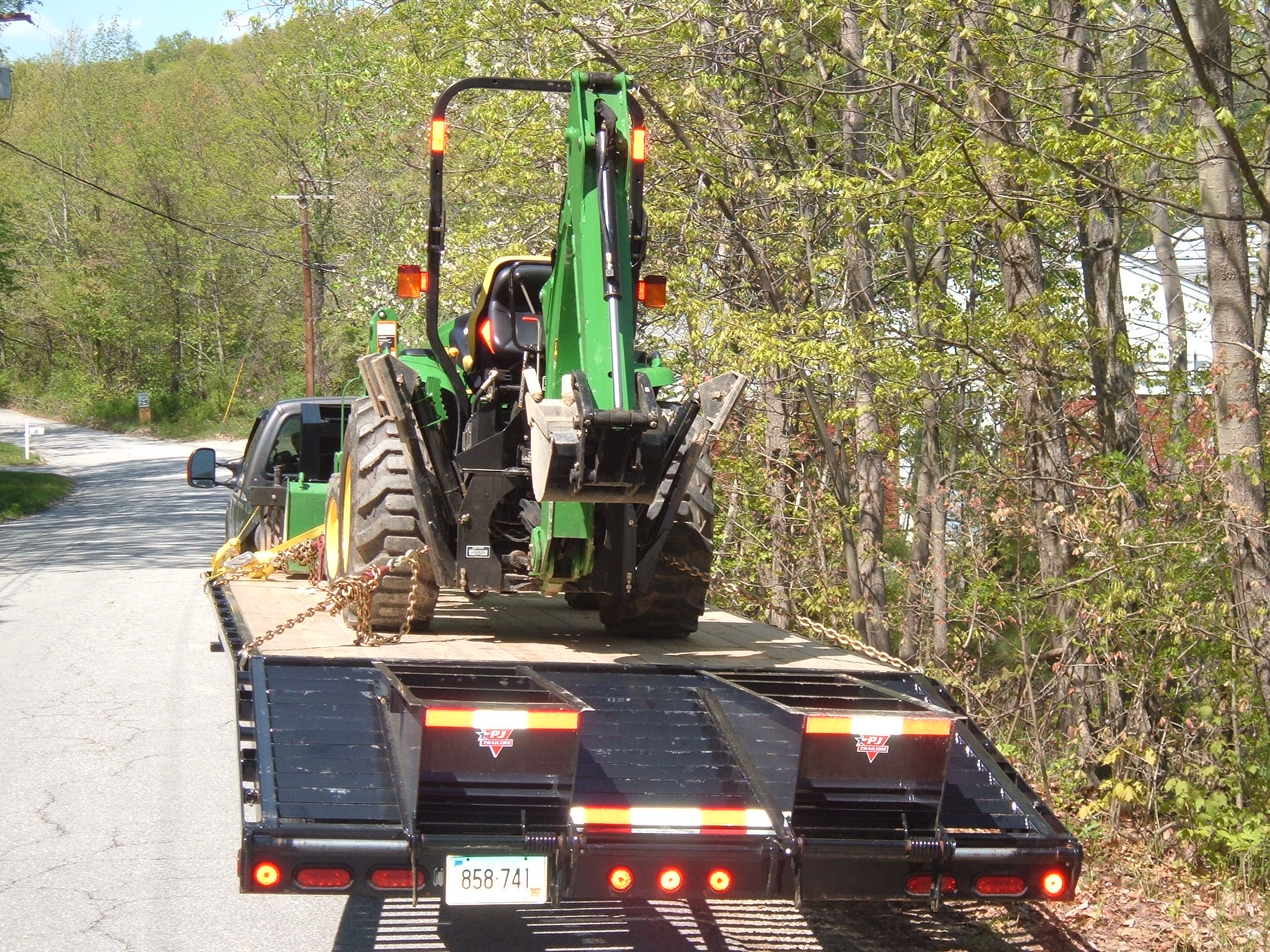

Here's my 20+5 102"wide with my 3320 TLB and rake. I've got the three ramp option so when they're flipped I've got a full 25' of deck. With my brush hog on I use up most of the trailer.

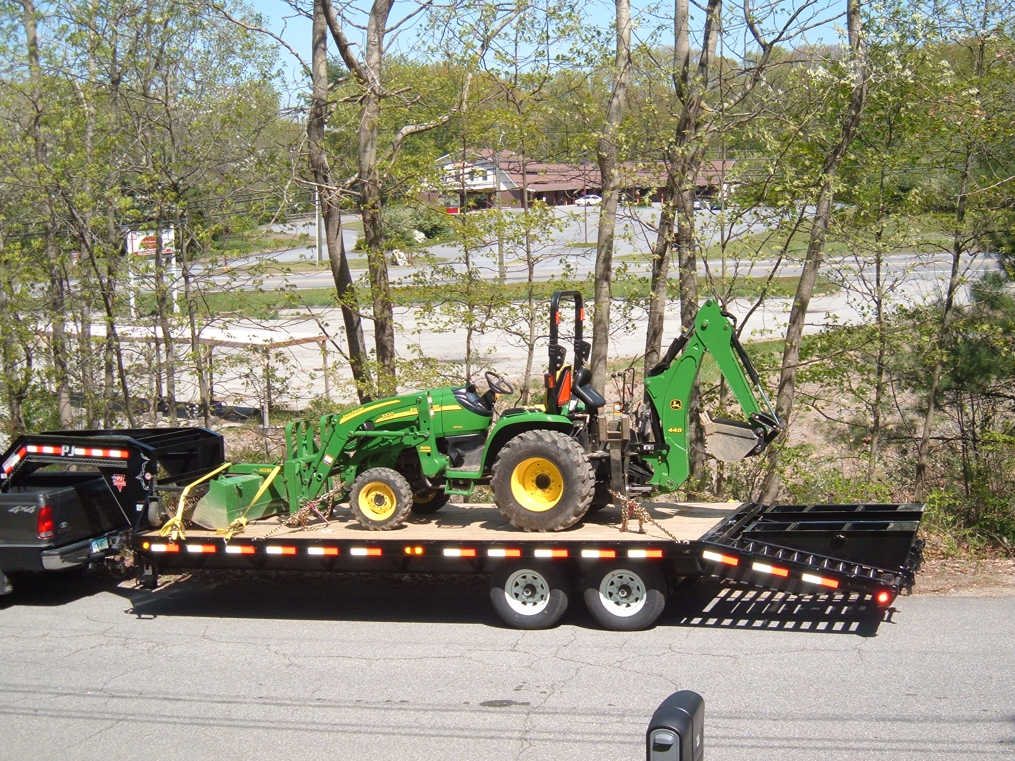

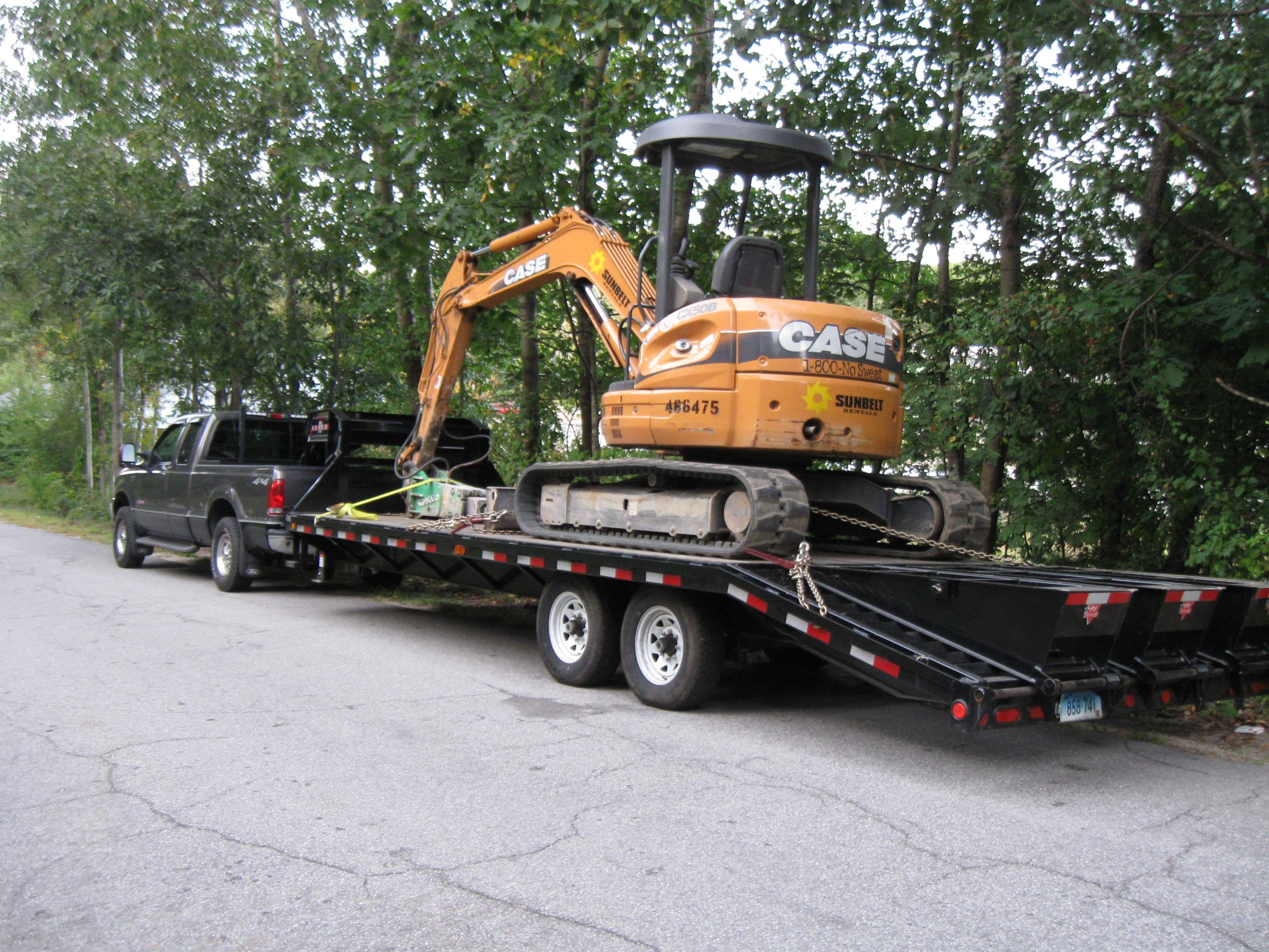

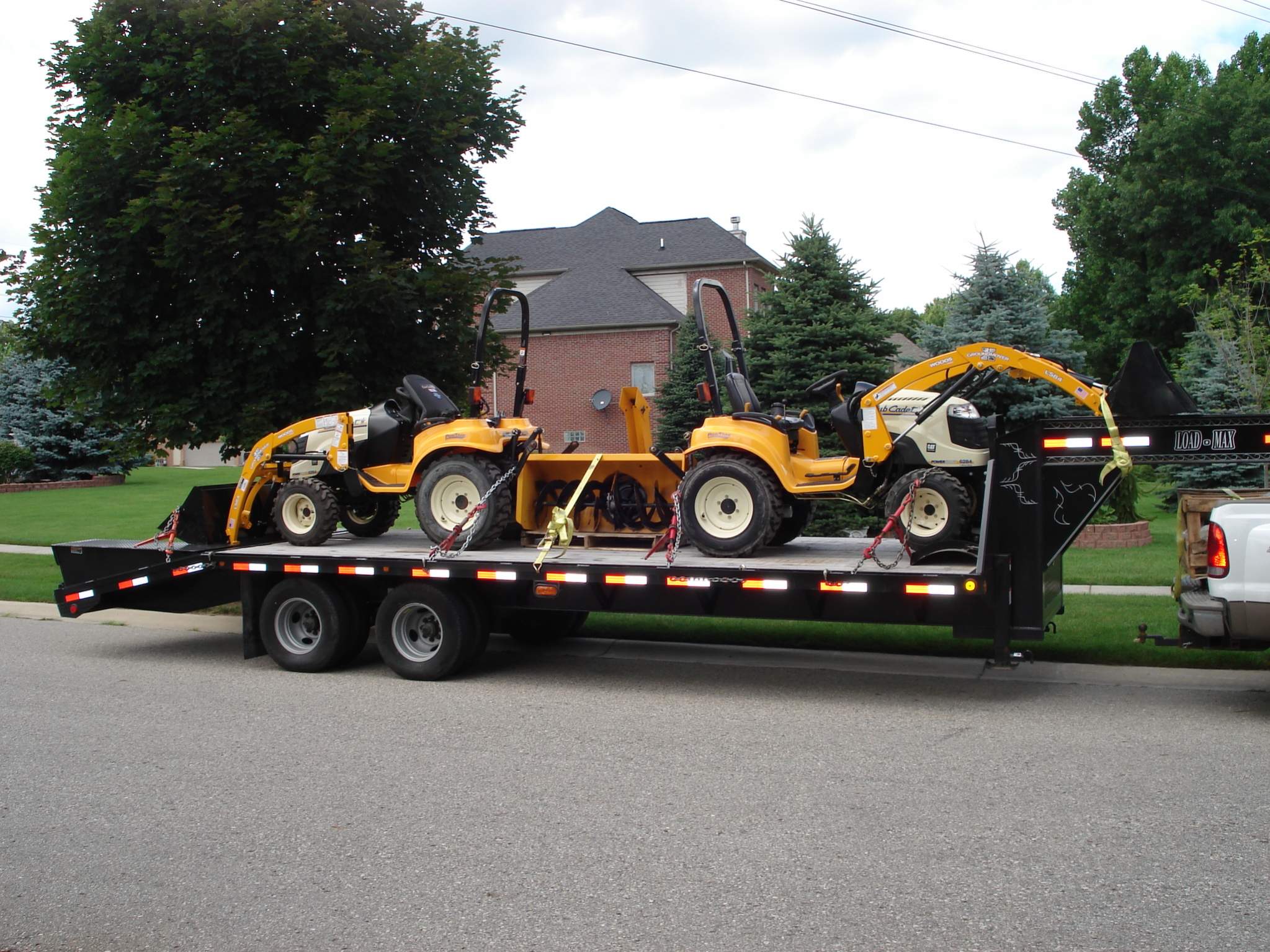

200 bucks is DEFINITELY worth it. Can you go any longer??? The first pic is my first gooseneck, 20+5. Then I stepped up to the 25+5 in the second pic, with 12K axles and triple ramps. The extra 5' makes a difference....
