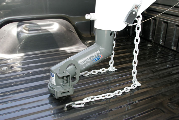

Hi-anyone have experience using gooseneck extenders. I have a short bed p/u and a new 8'wide trailer that I kissed the back window with and I want to do what I can to avoid that again. Looking at ones that go in the bed hitch, and ones that go in the trailer hitch and I can't find much about which one is best (better) or the relative advantages or disadvantages of each. A new LWB pickup is not in the budget at this point. Any help from folks would be appreciated. Thanks. Bill

All I can tell you is watch your bed rails. The extender helps save the back glass but limits clearance to the bed rails in a tight turn.

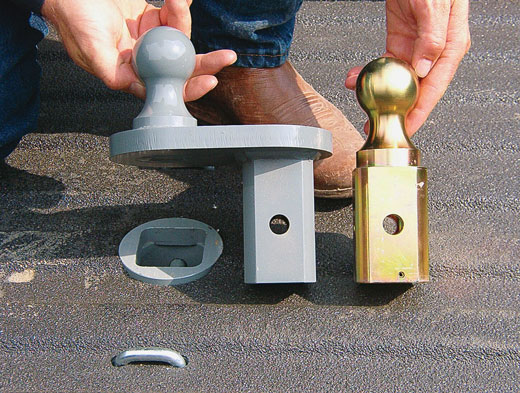

We have a friend with a short bed F150, she uses both.
attachment.php
attachment.php

No problems. It is a two horse, 8' wide, slight taper on the nose, with a small dressing room. Going forward she can turn full lock, do a 360 and it clears the cab and the side of the bed. The bed is the shortest, 5' or 5.5', whatever Ford uses.

I can't vouch for that taller tube type posted above, never seen one. Pretty neat though. But I've used the other, flat plate type. I had a 1 ton mega cab, very common to mash the cab on these with an enclosed tongue gooseneck. I pulled at least 20k, probably more with that setup and never a problem. The hitch and extender were both b&w
