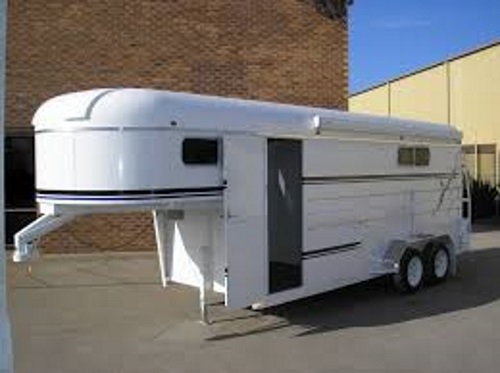

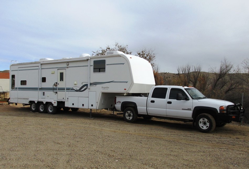

The type of gooseneck trailer.
No problem:

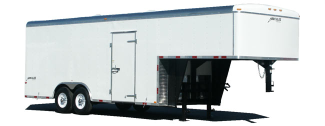

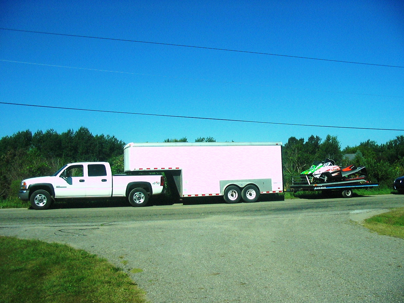

Possible problem:

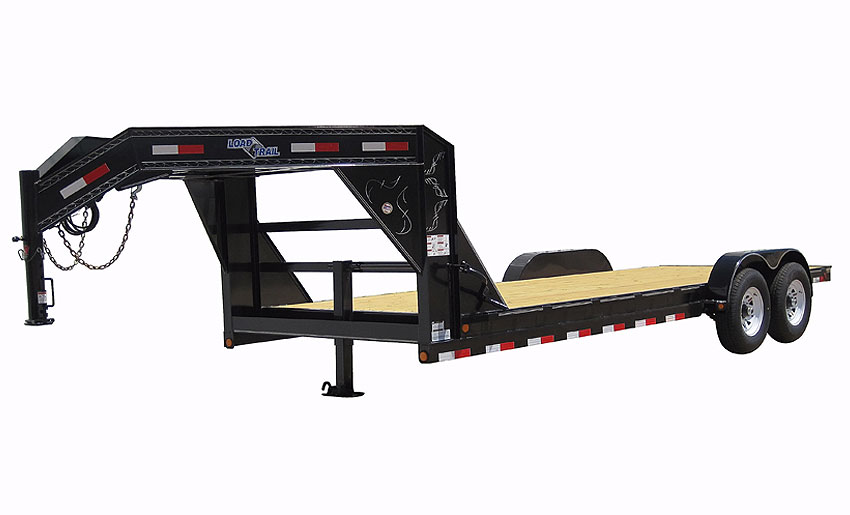

It's not really a concern to hit the cab with most farm-type trailers, as you would need to be well beyond 90deg to the trailer.
See how the trailer narrows to the hitch?
So the concern with this type of trailer is that if the hitch frame is not high enough, the bed sides or tailgate can contact it going over uneven terrain, and cause damage. I made my trailer with about 12" of clearance to the bed rails for this reason.

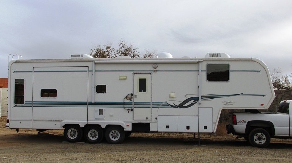

Gooseneck hitches are not used on factory built camper trailers (caravans), but the 5th wheel hitch location is similar, at generally 4-6" ahead of the rear axle in the middle of the bed. Cab clearance when turning can be a problem if the front of the camper is wide and the truck has a short bed. My "home" is this type of trailer, and because I have a short bed truck, I must be careful when turning sharp. I have lightly dented one side of the cab already!
Because shorter truck boxes are becoming "standard" here these days, many modern campers have a tapered front to prevent this concern. There are also 5th wheel hitches available that can slide back to provide more clearance for tight turning.
I also have an enclosed cargo trailer, which is gooseneck. It is also older, and made for a long bed truck. I must be careful because this trailer is not designed with much clearance to the bed rails OR to the cab. If I turn sharp, the front corners WILL break out the back window!! This trailer also has contacted the tailgate lightly, and when a friend borrowed it, dented one of the bed sides when he slid off his driveway because of ice.

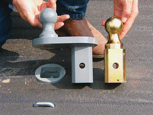

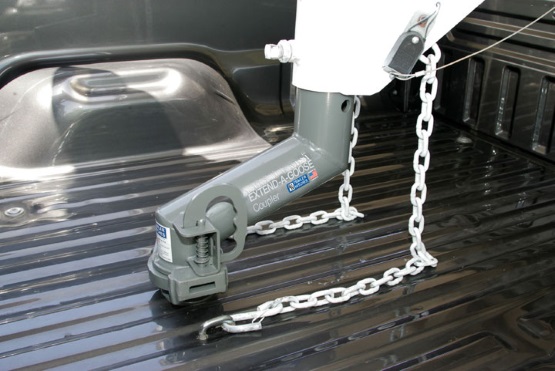

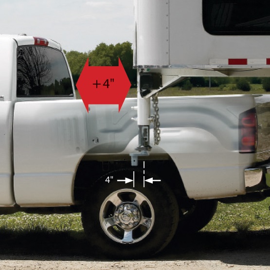

These are available for trucks and trailers with not enough clearance:
Moves the trailer back 4":
Moves the trailer back 9"
