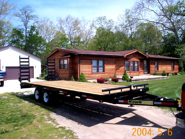

Willy I have a 8' x 20' 9,950lb. GVW deck over trailer with 2ft dove. With my TC45's bucket in the fully extended dump position and pulled as far forward as I can with the teeth up against the front tie down bar on the trailer my 6ft. Squealer's tailwheel barely hangs off the back.
After figuring your specs on the length of your tractor with front end loader and 6' bush hogg your going to be just over 22ft long. My specs were just over 23ft. From that you can subtract a few feet by extending your bucket in the dump position. I'd say shoot for a 20 footer with ramps or tilt. If possible get a goose neck as you explained you wish you still had. /forums/images/graemlins/frown.gif A lot easier and safer to pull that way as you probably already know. Brakes on both axles is nice. I feel a lot better that way but then again I am pulling it with a F-150 who wouldn't. It's all she wants to handle with that load. Only have to haul it 6 miles from my current residence to my property I just bought back in December. Other than that my father has a 3/4 ton Dodge Cummins I can use too for pulling, like to the dealer. /forums/images/graemlins/smirk.gif
Here's a pic of my trailer. Sorry I don't have one with the tractor loaded on it for reference. Hope this helps. /forums/images/graemlins/smile.gif

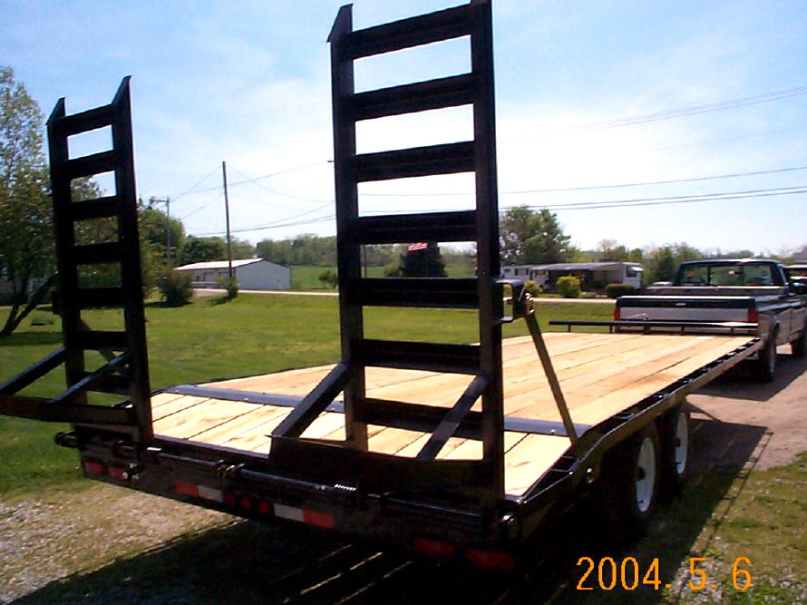

Another agle!

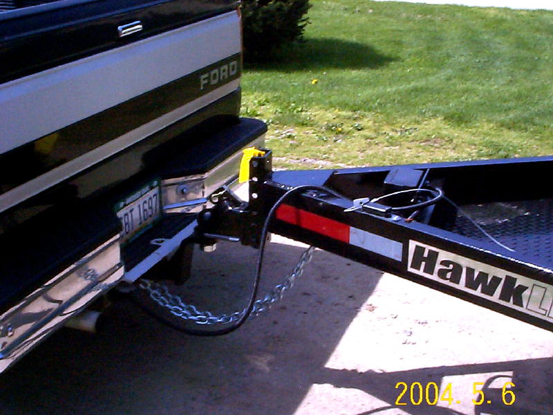

One of the tongue.
</font><font color="blue" class="small">( Could you load the bush hog up front and then pull the tractor up behind it and have the FEL over the top of the bush hog? I think this would help save length, but what about tongue weight? )</font>
You can do it that way but it is so nice to be able to leave her hooked up unload the unit and get to work. I wouldn't worry about your tongue weight too much, you have the truck for pulling it and plus I'm assuming at least a Class IV hitch if it has the factory installed tow package on it, maybe a class V on your truck? I put air shocks on my little F-150 bought a weight distribution kit and she isn't bottomed out yet. That weight distribution kit made a big difference but didn't have it at the time this picture was taken in case your wondering where it's at.
Good luck Willy in whatever you get! /forums/images/graemlins/grin.gif /forums/images/graemlins/grin.gif /forums/images/graemlins/smile.gif
