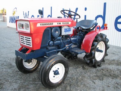

Have you thought along the lines of some of the smaller Yanmars ? YM135, YM155, Ym1100, YM1300 etc. ? I have a couple of classic Cub Cadets ( model 70, 100, 109 ) that I use for what you are describing but I spend way too much time trying to keep them on the road.

Thanks Bruce, real nice Yanmar. I like the Yanmar, just that I'm not looking to spend much $. I would think a diesel SCUT like this even in rough condition would run a grand and Im looking to spend no more than $500, preferrably less. Do you have any pics of your Cub Cadets?
