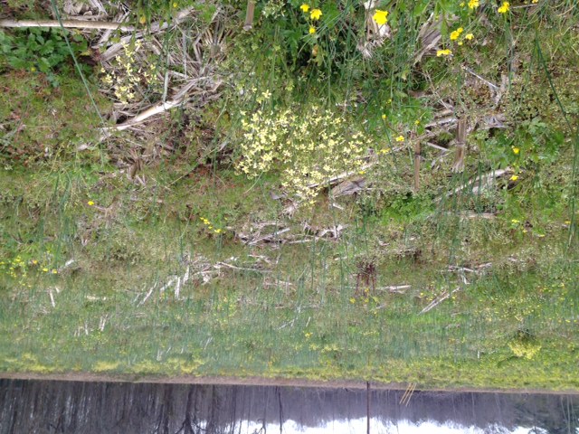

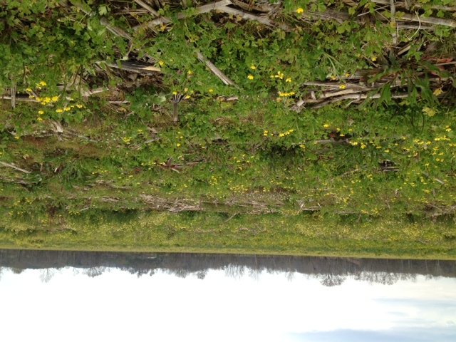

Leonz - Thank you for the comprehensive advice. Its quite a lot to think about to be honest. Unfortunately the tenant is a multi-state farmer and is not much interested trading cash for the use of 3-5 acres. I would imagine its more of a headache for them than its worth. Basically the previous deal was that the leasee maintained the drainage ditches that run across our land (which also serve the rest of the crop field that we do not own) as well as occasionally brush hog it in the off season.
Basically we lose use of the land in exchange for the maintenance of field drainage as well as brush hogging. In any case here are some photos of the property and the vegetation currently in the field.
*Edit* Apologies - For some reason the majority of the pictures are upside down and I cannot get them orientated properly.

   / Good Moring New BX2360 Owner with Questions #7
After looking at those pictures I wouldn't try to cut that with a mmm on my BX. They're great little tractors and pretty tough but that's a lot of heavy mowing there and the mmm isn't really designed for that.

   / Good Moring New BX2360 Owner with Questions #8
I would agree with rbarker. A little rough for the MMM, but a 42" brush hog would be perfect for it!
