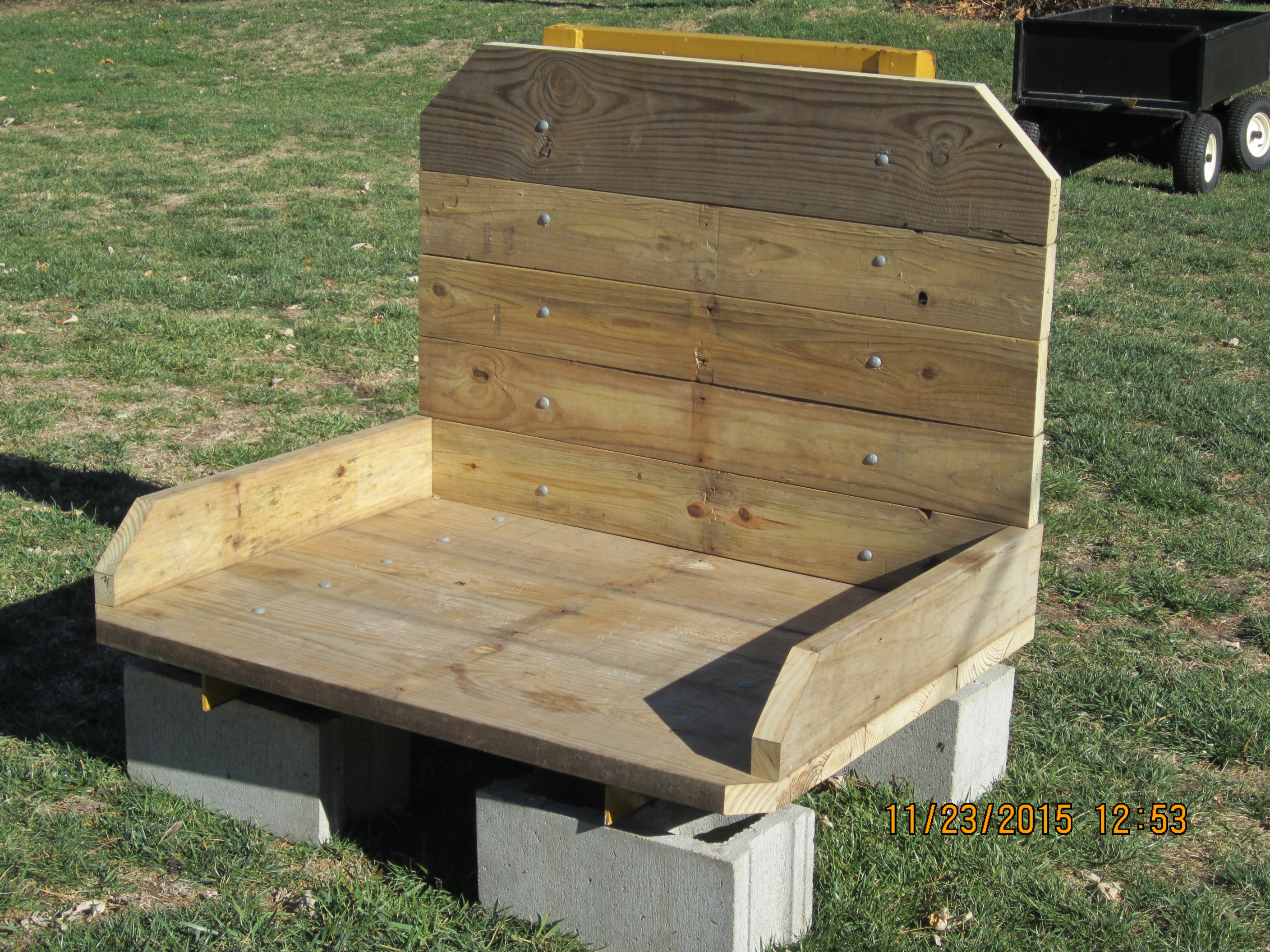

   / Good durable carry-all basket #9
This one I built as an all purpose Carry All, using the TSC frame. It could be tailored to use for different purposes as needed. Having some scrap lumber kept the cost down...added another coat of Cat Yellow and some galvanized bolts.........probably have about $115.00 in it.

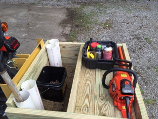

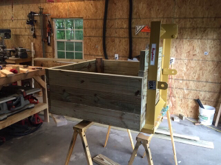

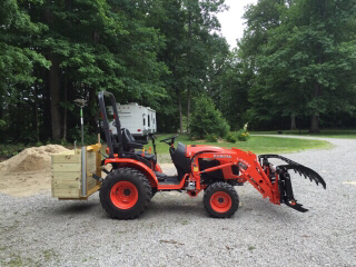

   / Good durable carry-all basket #10
I built my own but made mine detachable... helps to have hydraulic Top and Tilt but I used it a bunch with the screw type top link.
