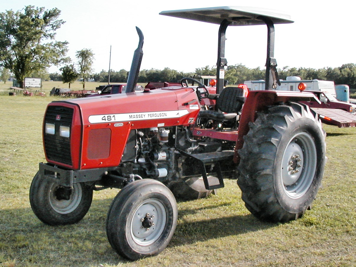

Hey guys, ready to buy new Kubota M7040. Just don't feel like paying that much. I came across this MF481. I thought it looked like a good deal.
My questions are: it's a manual transmission, but does it have a shuttle lever for forward/reverse? I can't imagine doing loader work having to clutch & shift to "r"
It's got the venerable Perkins 4 banger-no worries there. Tires & overall condition & low hours look great.
Any comments appreciated.

There were two transmissions offered in the 481, a mechanical 8F/8R shuttle and a non-shuttle 8F/2R. If it has the shuttle then it'll say "shuttle" on the rear of the hood and will have a F/R lever on the left side of the steering wheel. The massey's is a standard shuttle, you have to clutch between forward and reverse. You can get the kubota setup that way or with their hydro shuttle that you don't have to clutch. My tractor's 4wd with a FEL and I use the FEL quite a bit. The clutching personally doesn't bother me at all, but then again I grew up driving manual transmission tractors and vehicles so it's second nature to me, I just don't give it a thought at all. Again, to me "old school", simple and basic are what I prefer. Only you can decide if clutching bothers you or not.

It is not a shuttle. MF puts a seperate label on the side that says shuttle if it is. You also should have been able to see the handle under the steering wheel. That is a good price on it though. 1rst and reverse line up on the shifter. On my 596 I use that like a shuttle but it keeps the right hand busy flipping the shifter back and forth and running the loader too.

I was afraid of that. That tractor would have been perfcet for me at that price with a reverser. :mad:
I knew the price was too low. :(

I should have mentioned you won't find a 4XX or 5XX series with a column reverser. These are all the plain jane series and the shuttle is a manual gear shuttle, not a power shuttle. They are meant to be a basic utility ag tractor and don't have some of the nicer features.
Here is a 481 near me that is going to be auctioned next weekend. You can see the shuttle label on the side under the 481.
I owned a 481 open station, MFWD and with a MF1070 loader.(the 1070 was actually 1 size over the recommended size for that tractor.) I did quite a bit of dirt and loader work with it. I had a side job for awhile and I could load a lot of shale in a dump truck, but it wouldn't keep up with a Case 580 backhoe that worked with me part of the time. The mechanical shuttle sure wasn't as slick or fast as my nieghbors JD with power shuttle. That said it was good for what it was meant for and I prefered the longer reach of the MF 1070 loader over the DL260 that I now have on the 596 for loading hay on trucks.
