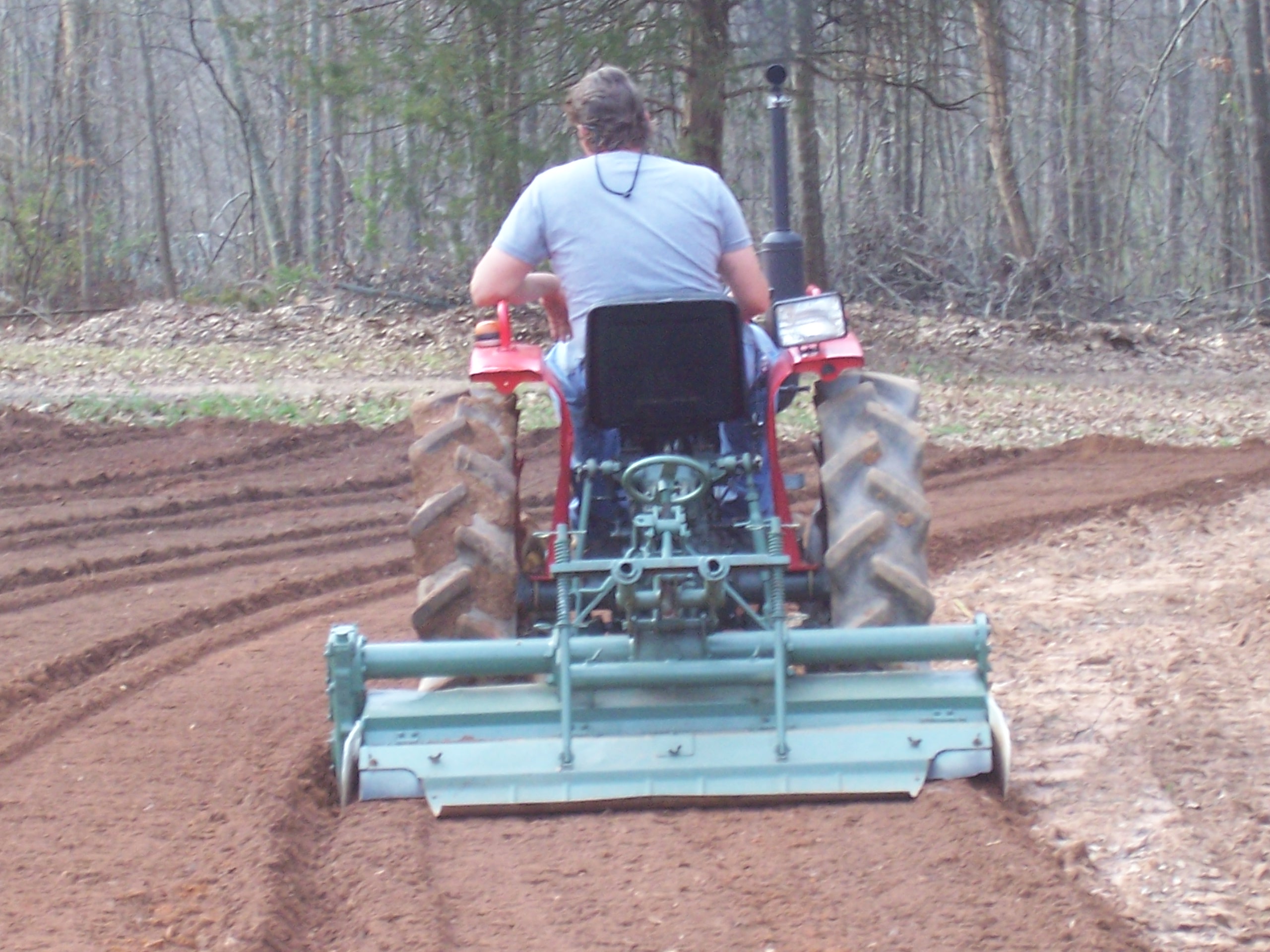

There's a 1404 on CL. in Ga. for 500.00 also. Here's a pic. of my 1400 on a 2000. I never found a need to have the Gauge Wheels in Ga.. About the only parts Available for them now is New Tines. They were at Fredricks and the Tiller came from them also. I gave 675.00 for it in 09. with basicly just Tines and Painted and no Wheels.
