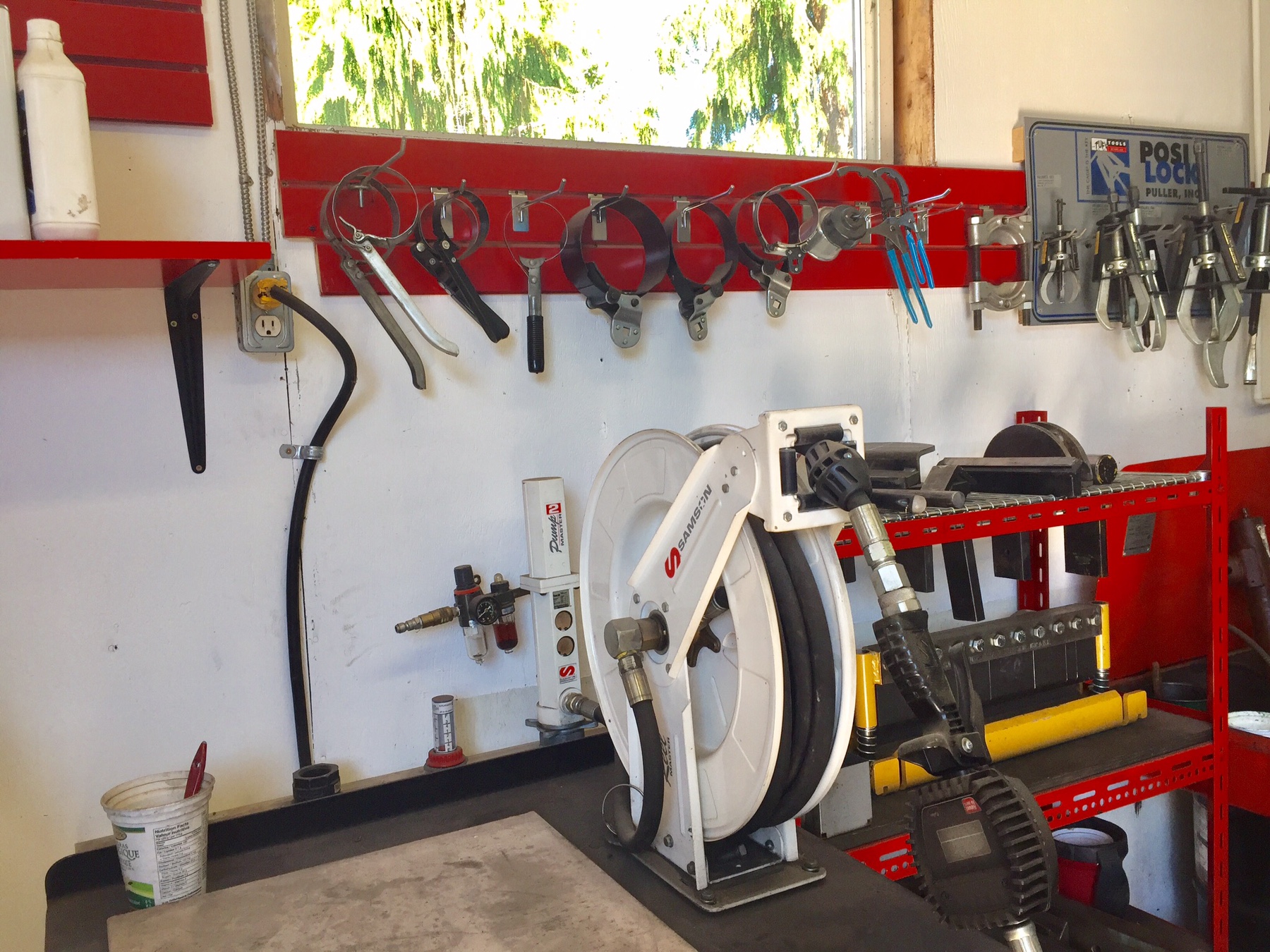

Tried to pull the HST filter on my L4060hstc today & failed. 50 hour service so the OEM one was painted on gluing it in place after the Japanese gorilla torqued it on. I have an oil filter wrench, plastic handle with a reinforced rubber strap. But it's not beefy enough or long enough. I can't get nearly enough leverage to pop the filter loose. Any recomendations for a beefy wrench I can put a 1/2" breaker bar on or has enough leverage?

I use a wrench like the one below . You can find them in 3/8" drive or 1/2" drive . Use what ever size ratchet you need and a extension in the end and spins them right off .
The one I have is a Cat Brand that I bought at a commercial truck dealer . Pretty Heavy duty .
Fred H.
   / Good big oil filter wrench? #4
I have a filter wrench similar to this that works for me. It uses a 1/2" drive ratchet or breaker bar.
Steve
PS -- Fred's looks like a heavy-duty version of my strap wrench.
   / Good big oil filter wrench? #5
I'll second Fred's strap wrench. It will get them all off but can be (and is) cumbersome to use. I recently got a set of HF 'cup type' filter wrenches (more like sockets) that fit over the end of the filter grabbing on to the flat spots. 4-5 sizes and usually one will fit, a decent "set" for around $10, but I still have a drawer full of various filter "wrenches" and they all get used per different situations, and accessibility.

I have these and love them. They get the most stubborn filters off though you will likely crush or even puncture them in the process.
TEKTON 5867 16-Inch Oil Filter Pliers - Automotive Oil Filter Pliers - Amazon.com
3 'thumbs up' for the pliers type. The handles are long so you can apply plenty of leverage and, as a bonus (for me, at least) it also fit the cap fitting for my hydraulic filter.

4 thumbs up for the pliers, tried every wrench I had on the Deere last month, the pliers work.
