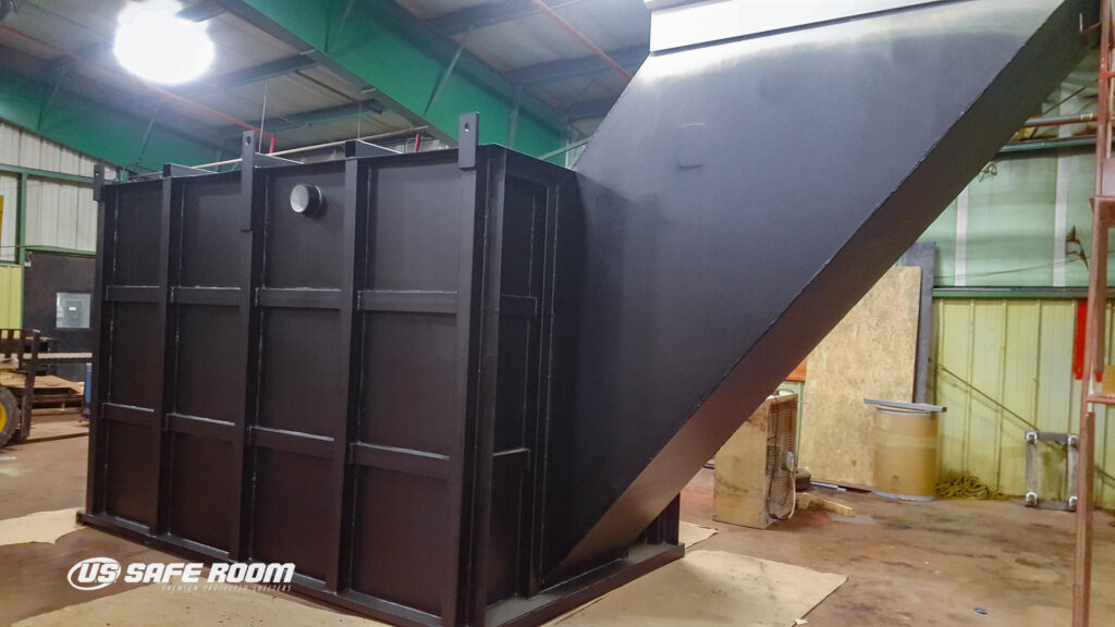

This underground safe room is waterproof and equipped with all the comforts of home.
Below grade commodes are common, they have a macerator pump to lift sewage to the level of the city sewer or a septic tank.
Don't faint when you look up the price.
If you only want an underground shelter, this waterproof one-piece fiberglass unit is much less money.
