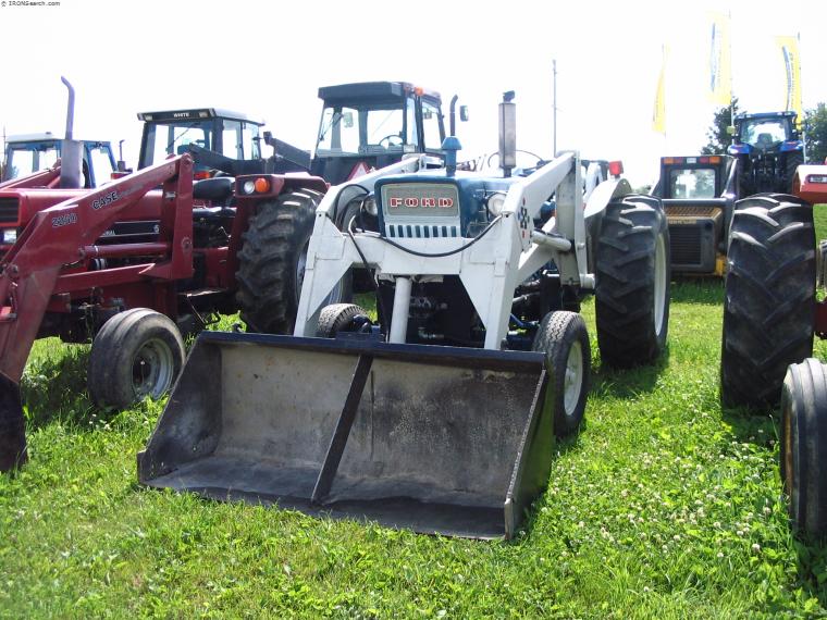

That is why I figured I could not pass up seeing it. I have attached a photo, maybe you can see something I can't.

Not alot to work with there. Looks like the drawbar has been broke at some point and welded/patched maybe? Check the front end close...use the loader to lift the front wheels off the ground and get off to see how much play in the steering. let the weight back down and note how much play there is between the top of the axle knee and the steering arm. Check to see that the power steering is actually working, I looked at one recently that there was something wrong and it was armstrong all the way. Hold the brakes while letting the clutch out and test the clutch some, see that the brakes work alot of the obvious stuff like that. It may be a bit bigger than you need, and will use a little more fuel, but probably not talking about 8hrs day/6day week operation here either. More is and advantage when using a loader or moving snow it seems...

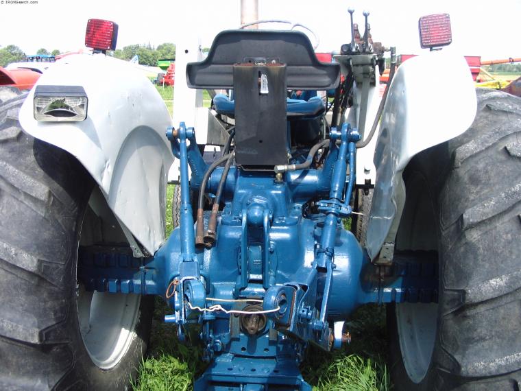

The other 2 pictures I was able to get. Probably not the most helpful as they are not real close.

hopefully it's an 8spd and not an sos.
make sure the pto operates under load.. as to hitch it to a mower or something.
I'd be less worried about a loader on a 5000 vs a 3000. the front end on the 5000 is much heavier duty of design that the radious rod setup the 3000 uses.
still.. steering components onthe early 5000 are $harder$ to come by.
make sure she starts good cold.. should have a big beefy 4dlt battery.. unit originally came with a gen.. make sure it charges.. or alloy for 140$ to rebuild the lucas gen and repalce the vreg. make sure dash oil lamp works.. that's an important one.
good tractor.. I love my 5000. late ones are 70eng and 67 pto and are 256ci
the early ones are 233ci.
