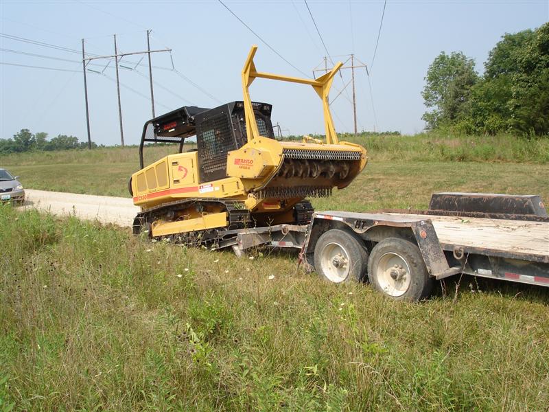

Here's a picture of the C130 being loaded on the trailer prior to moving to another section of the power line.
(BTW: I'm uploading some videos to YouTube of the machine in action)

   / Going to a Rayco C140 demo tomorrow, what do you reccomend I ask or check out? #9
I was surprised to hear the tracks clicking, and what is the chute in the back?
jmf
   / Going to a Rayco C140 demo tomorrow, what do you reccomend I ask or check out? #10
Sound just like a dozer, which it should because of the steel tracks.
That's a winch on the back.
