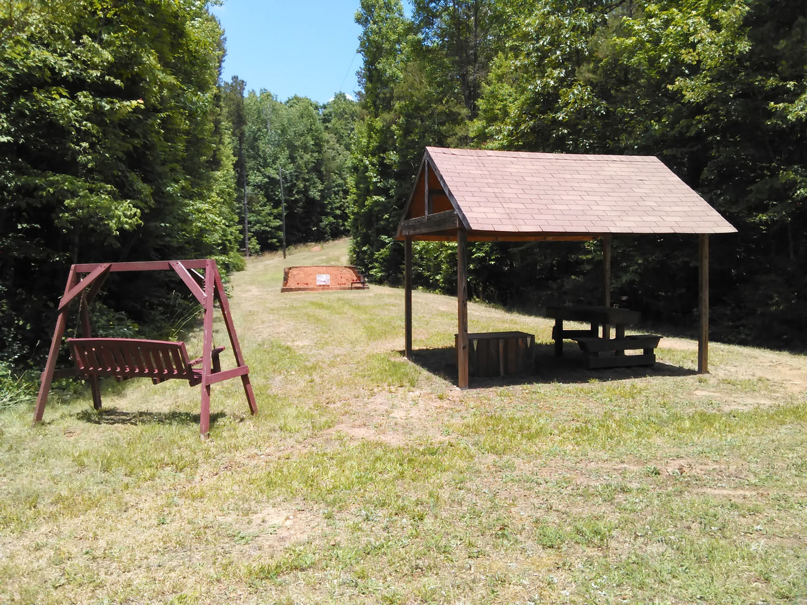

We got three goats early this year. Adopted from a neighbor who wanted to reduce her herd. We built a pen and a house for them, and enjoy them as pets. Everybody who visits enjoys them. They've been a good addition to the family.
That's the good news.
The bad news is, they don't like gunfire. My shooting berm is about 75 yards from their pen, and gunfire freaks them out. Even rimfire noise is a bit too much stress for them. So, I decided to relocate my range deeper into the woods. Picked a spot in a small valley with a good natural backstop. It's 150 yards further away, with thick tree cover between it and the goat pen. It's also that much further from our house, which makes the noise more palletable to everyone who isn't shooting, including my neighbors. Spent a couple of weekends improving the new range, and it's now actually a nicer place to shoot than my previous setup.
And that brings me to a cleanup issue: The old shooting berm is railroad ties, in a flared "U" shape structrue, filled with red clay soil (pictured below). And, as you might imagine, after years of use, its some of the heaviest red clay on the planet. There's a lot of lead in that pile of dirt. Environmental issues aside, I cast bullets, and want to reclaim the lead.
Any suggestions for a good way to reclaim the lead?
