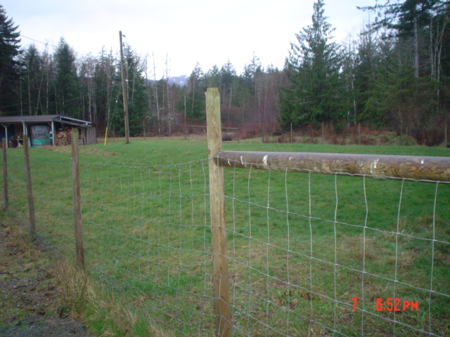

We use a mesh wire that up our way is called page wire, it has smaller squares at the bottom and get a bit larger near the top. Works well for our goats. We have 3 fenced pastures for the goats, 2 that require a walk to the fenced in pasture. We have a fair amount fenced and they have not tried to escape yet. :laughing: Pic 1 is a corner of our middle size pasture. Pic 2 and 4 they are in a largest fenced pasture although you can not see the fence. Pic 3 they are going to the barn from our largest fenced pasture. Note: the funny looking goat is our late dog Amber.
