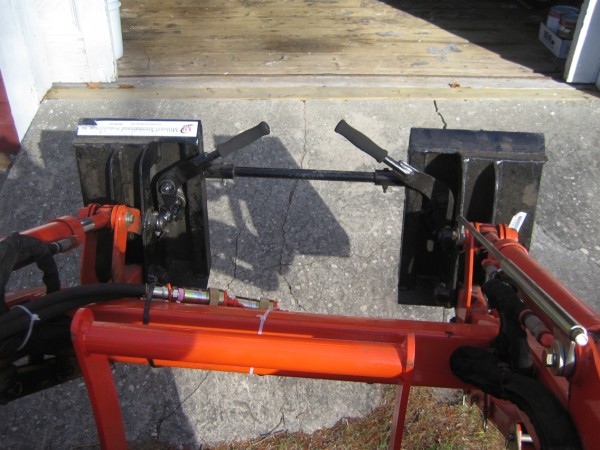

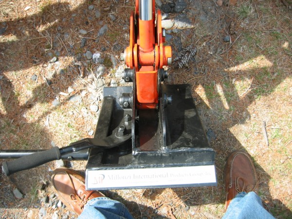

I'm sure the ATI is fine. Horst Welding also makes a similar adapter which I believe is a bit less money. I have one and have been very happy with it.

   / Go with ATI quick attach? #4
So with this adaptor, you then re-attach the bucket to the adaptor?
Thanks for the pics.
I'd like to have an adaptor for pallet forks. I think Bradco makes forks.
   / Go with ATI quick attach? #5
When Kubota built the 682 they didn't offer a quick attach and we used the ATI system even before that. For that money I hope that the plate is welded on the back of the bucket for you.
   / Go with ATI quick attach? #6
I'm a bit confused by your question. The Horst adapter works exactly the same way as the ATI. Two levers that secure the adapter to the QA attachment points on the implement. You can take your original bucket and have a QA adapter plate ($150 for the plate) welded to it (be careful of the angle to insure your dump and roll angles are preserved).
