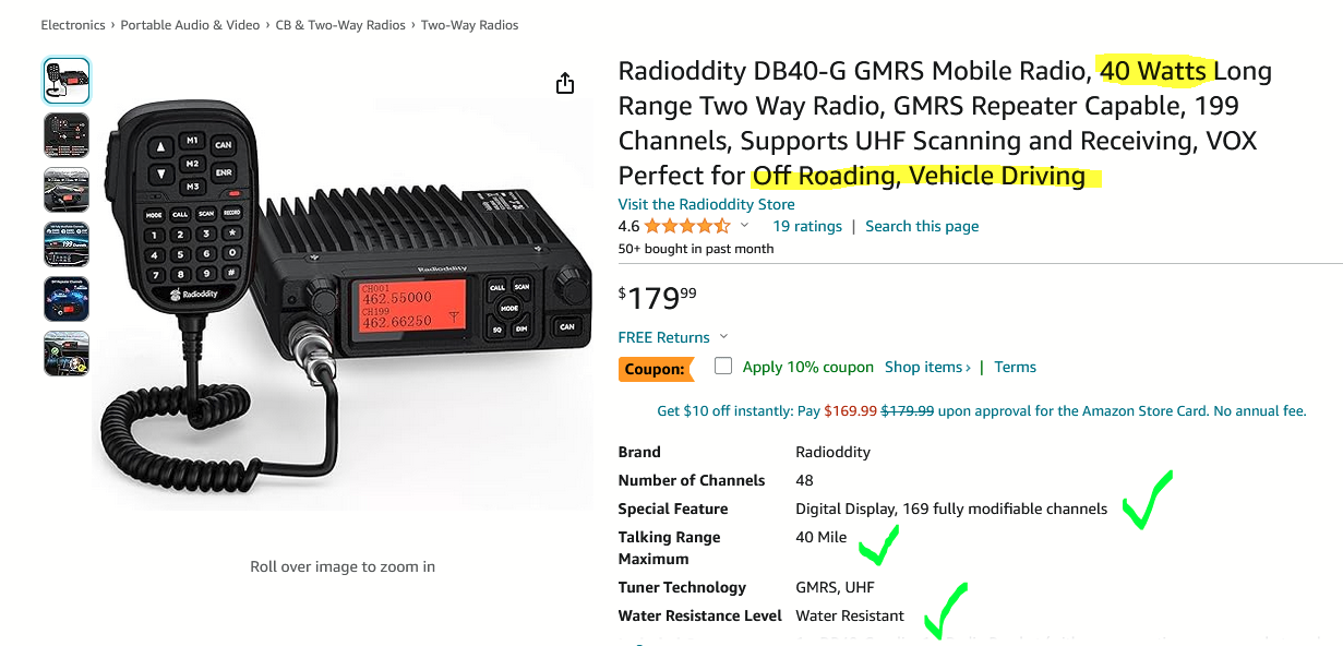

Midland makes a 50W GMRS Farm & Ranch mobile unit for either a vehicle or cab tractor. It is very pricey though. It is as srong as a Ham 2M radio for power. It will require a license too.
Now, if looking at Ham radio, 2M simplex (60 mile radius coverage max @ 50W) is very clear and clean, lower cost license renewable every 10 years and the radios are 1/2 the price. Plus, with the Ham usage, you are not restricted on antenna heights, placement and sizing.
   / GMRS and cab tractor #3
I’m curious. Has anyone here put a GMRS RADIO in your tractor cab?
We are fairly mountainous. And cell coverage is not so good… so I’ve considered it…
Thanks.
oh, and the Radioddity is reasonable should you stay in the GMRS realm.
Amazon.com
