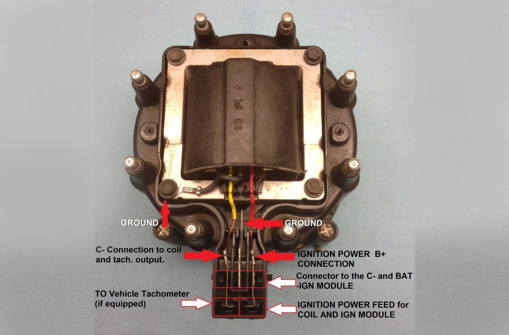

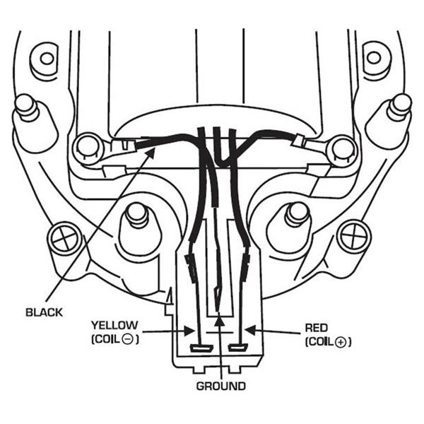

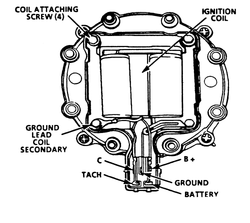

Took apart the ignition portion of the HEI distributor for a '82 GM 350 v8, rodents chewed the wires.
Took weeks to find the ignition module wiring assembly, got one from Summit Racing, the module itself was sourced locally.
At any rate I cannot remember how to put it back together again, like Humpty Dumpty. Anyone have a image of how it goes?
   / GM 4 Pin HEI Distributor Assembly Assembly #2
Here's a few pics from the net. Did a search for HEI ignition wiring diagram. Hope these help.

   / GM 4 Pin HEI Distributor Assembly Assembly #3
Thats some good pics right there.
Super Dude! Thanks.
Removed the cap and rotor, disassembled the innards and forgot how to put it back together.
Found an old Delco ignition system picture, probably out of a manual, put Humpty back together again.
