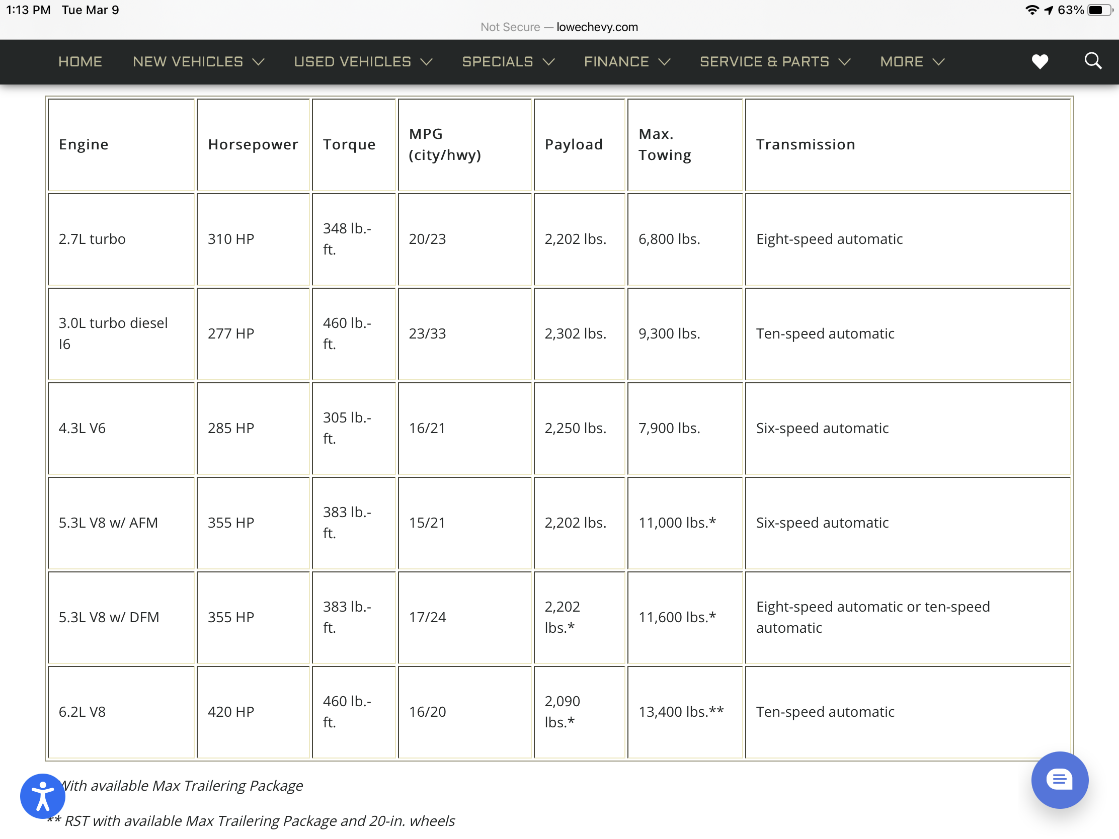

Been liking at a new Silverado 1500 4x4 with the new 2.7 Turbo I-4 gas engine. Really impressed with the low end torque, it's all that I would need.
Does anyone on here have one?

What’s the payload on the truck? It sounds like it fairly light which might give it a good payload number. Pretty good 1/4 mike times too.
   / GM 2.7 I-4 Turbo gas engine.
They rate it to tow 7,000 pounds - that's all I need.

I don't get your anti gas yuppy comment. They compared the 2.7T to a 5.3. Both are gas engines. Despite the published mileage ratings favoring the 2.7T, they got the same average mileage for the two engines. The 5.3 had more HP, more torque, more towing capacity, no turbo, less complicated, and was only $1400 less than the 2.7T. What would you be gaining by purchasing the 2.7T over the 5.3?
I have a 2015 Silverado with the 5.3L V-8. I love that motor and would not consider a 4 cyl turbo that has the published specs- especially in year #1.
