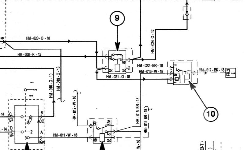

I had a mouse chew off the four wires that plug into the glow plug timer. This is the second time this has happened and the first time I had the dealer fix it. They did not use the same color wire so now I do not know where the wires are to go. They were chewed off at the splice just as the wires enter the timer. Three wires go into the top and One goes in the bottom left. The numbers on the original wires are HM 13, HM17, HM21,and HM22. Does anyone know the correct order of these four wires from Left to Right if looking at the timer.
Thank You
Joe
   / Glow Plug Timer Wiring for TC-35D 2003 #2
From left to right:
Top: [Spot 4, HM-021 O 18g], [Spot 5 HM-013 White 18g], [Spot 6 HM-022 Brown 18g]
Bottom: [Spot 3 HM-017 Black-18g]
On attachment, Glow Plug Power Relay is #9, Glow Plug Timer Relay is #10.

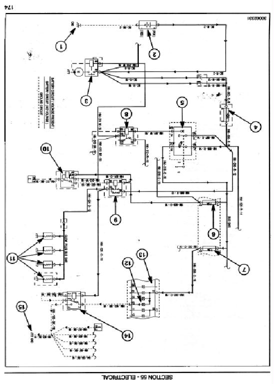

   / Glow Plug Timer Wiring for TC-35D 2003 #3
Second attachment that might be clearer.

Thanks for the info and the quick response. Those drawings came through perfect. This sure helps me get my tractor back to normal.
Thanks again,
Joe
