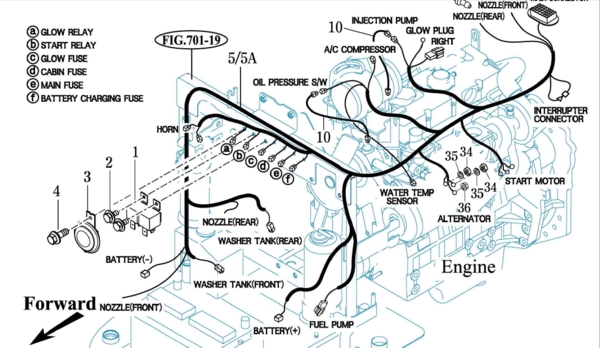

Trying to find the glow plug timer. I'm guessing under the plastic covers where the speedometer and behind the fuse box. I just do not see it under there. thanks - :mad:
   / Glow plug timer location #2
Don't know what size TYM you have. On my T433 and the T503 / T533, the glow relay [1] (has a built in 16 sec delay) is located under the hood, on the cross bar above the radiator, next to the glow fusable link, and horn.
