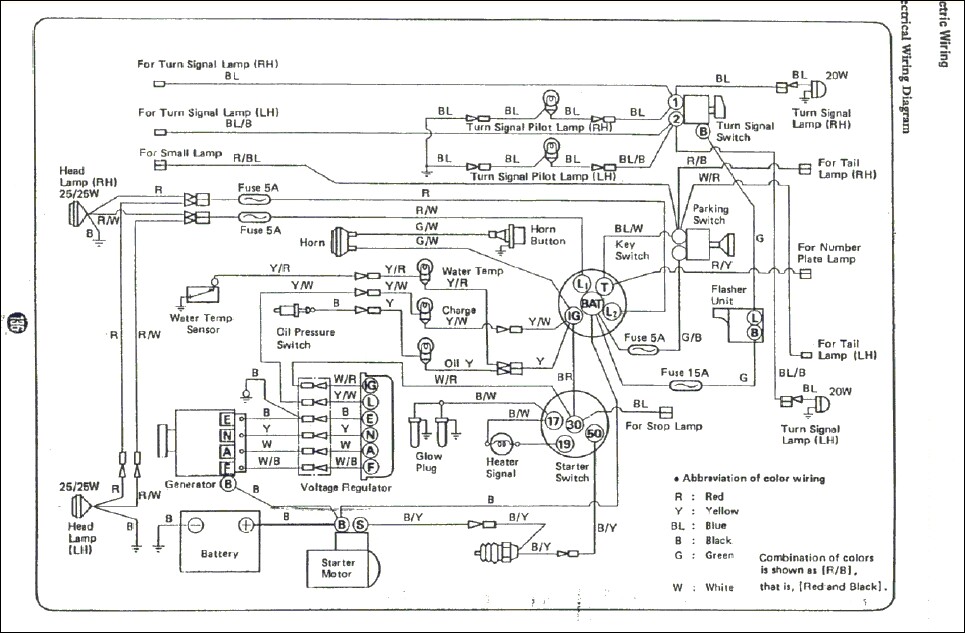

Hello all,
I have an iseki ts1610 and i have searched the site so if i am re posting i still cant find the answer...
Problem:
Last week i turn the ignition switch to heat the glow plugs --i warm them n see the indicator on then i crank it. Turns over stalls out. I go to re warm and i do not get the warm indicator to light. So i think i just need to replace the plugs. I order them put them in and still no indicator light.
So...checked the line going to the plugs and notice its no longer a hot wire. Which led me to follow the line to the dash and the ignition switch. The ignition switch will crank but it will not light the glow plug indicator. Right now i have the tank off and do not see any fuses... Any ideas?
Also when i say ignition switch its not the key - if i turn to the left light up then i turn to the right and it cranks.
Thanks
   / Glow Plug/ignition problem #2
diagram
