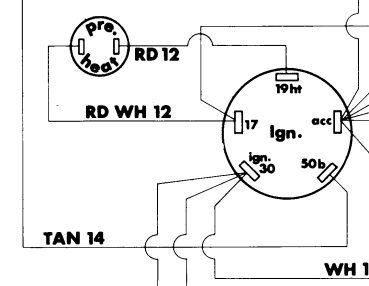

I'm fixing up an old Ford CL65 skid steer. Most all the non-essential wiring / gauges / switches were stripped out of this thing including the original ignition switch and the entire glow plug circuit (old owner just squirted a bit of starting fluid into the air filter whenever he wanted to go). From what I can tell from the schematic the ignition switch turns counter-clockwise to engage the glow plug circuit. When the indicator "glows red", you then turn the key clockwise and start the engine. The glow plugs are the pencil type wired in parallel. Here's an image of the ignition switch schematic and this mysterious "glow indicator": e7ZDYVwl.jpg . So here's some questions:
1. Whats happening inside the ignition switch with respect to terminals #19 & #17? (the extra wire off of #17 goes to the plugs). I'm thinking that in "pre-heat" mode terminals 30 and 19 are connected, but then what's #17 for?
2. I was going to bypass the indicator completely. I don't really see it as particularly useful, but it occurs to me that it may be providing some resistance and thus dropping the voltage down below 12V. Can I delete this indicator?
Just some additional info: There is no block mounted "block resistor" in this. The wire you see coming off terminal 17 goes directly to the plugs. They're all wired in parallel. I pulled them and they all seemed burnt, so I just ordered some NKG Y-107V plugs

Hopefully you'll get a better answer than mine because I'm only guessing.
I would think the preheat is just a simple thermal device so with ignition switch switched over it supplies power to glow plugs until preheat device opens.
On NKG site those plugs specs says 10.5v which to me should be ok on 12v, but you may want to call them.
Here's the # to NKG...888-800-9629
Me, I would want to put it back stock if not too expensive.

I don't really know what you have.
What is the indicator. A lamp or a heating element? Some Bolens type tractors had a dash mounted Element in series with the glow plugs. It would tell you what was happening. If it glowed hot, you knew the glow plugs were as well.
Others (like my Steiner) have a light, that is on a timer, but has nothing to do with the glow plug circuit. It's just a timer for the operator to watch.
Then, My mule has a timed glow plug curcuit that has an indicator light to show when the glow plugs are on and off (ready to start) and it does this every time, whether you need them or not.
So, there are a number of different systems in use.
Generally speaking, a cold 12 volt battery has limited power and reducing the glow plug power with a resistor that drains your battery and heats the great outdoors is not really a great idea.

It's actually a brilliant, simple, almost primitive idea. You are loosing a bit of stored energy needlessly, but knowing exactly what is happening with your glow plugs is probably worth it.

On that one I would at least wire in a light, that #17 to glow plugs , wire light there to ground. That way you know they're getting power and how long they're on.

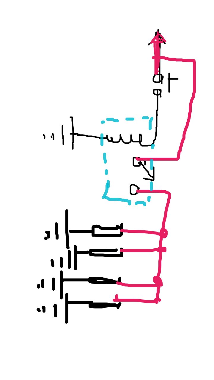

I am trying to get the glow plug circuit back together. I was planning on just wiring the circuit through a push button directly to 12V, but the whole indicator thing threw me and made me think it had more purpose than just giving feedback that the circuit was working. So I guess my question is if I can simply wire the plugs directly through a push button or do I need to find a new indicator (parts for this beast are nearly impossible to find)
   / Glow Plug Circuit (do I need a resistor?) #9
Maybe call NKG who can tell you how long they can/should be on. I'm thinking your best bet would be to wire in that device DL posted, it looks like a high current glow plug light assembly made for them.
NKG can also tell you current draw.
A Ford site (V8 truck) said "all 8 draw about*190 amps, so figure each one would draw almost*25 amps."
So a 4 cylinder would be about 100 amps, so you would need a hefty switch and wire, although they're not on long.
