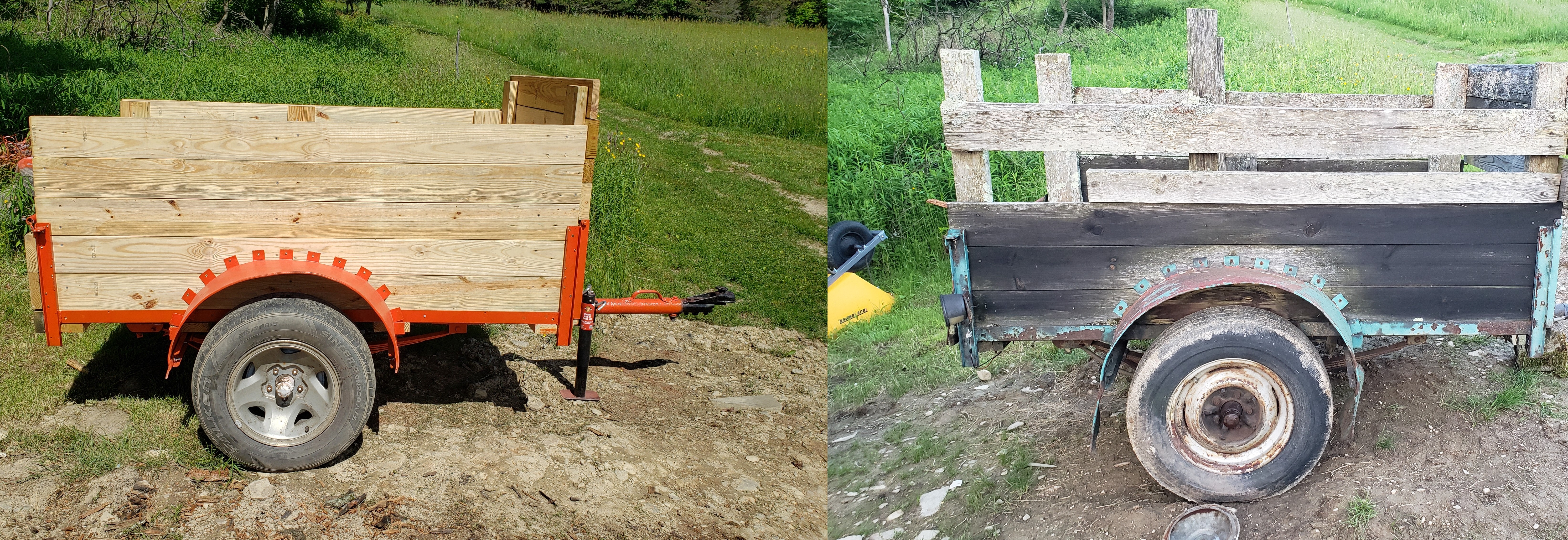

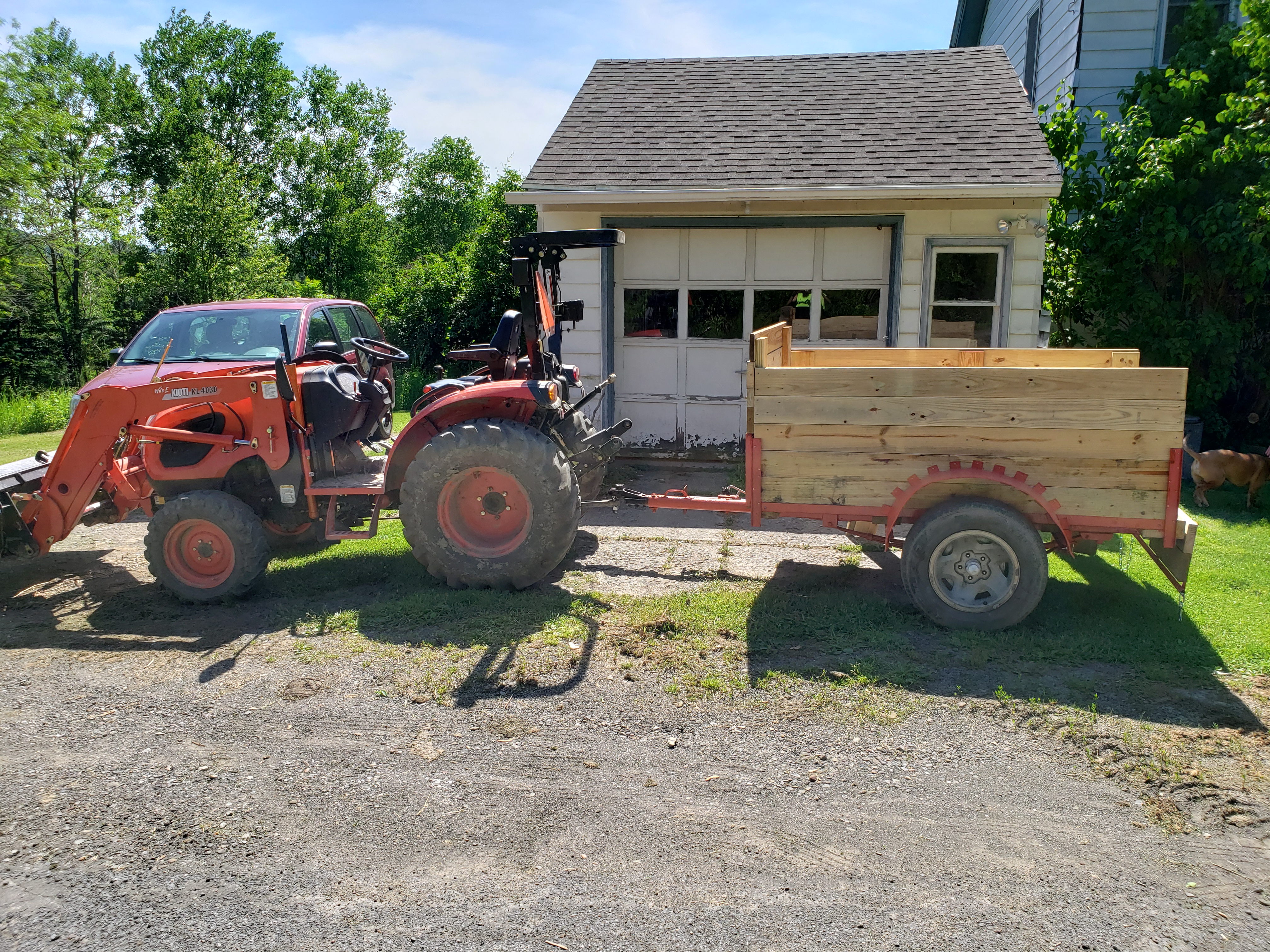

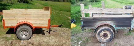

Got an old roached out firewood wagon from a neighbor a few days ago. It's 4'x8', so pretty decent size. It was in rough shape though. All of the lumber was rotten, and most of the steel needed a lot of cleaning up (and a couple small patches). 3 days of work later, I'm pretty happy with the result. Cost me about 250 bucks in lumber and other materials. Grabbed some wheels and tires from the junkyard for next to nothing, bought a cheap jack from tractor supply for the tongue. Primed and painted the whole thing top to bottom, with an "almost" Kioti Orange. No intention of making it street legal, it's just for hauling firewood on my property, and any other tasks I come up with.

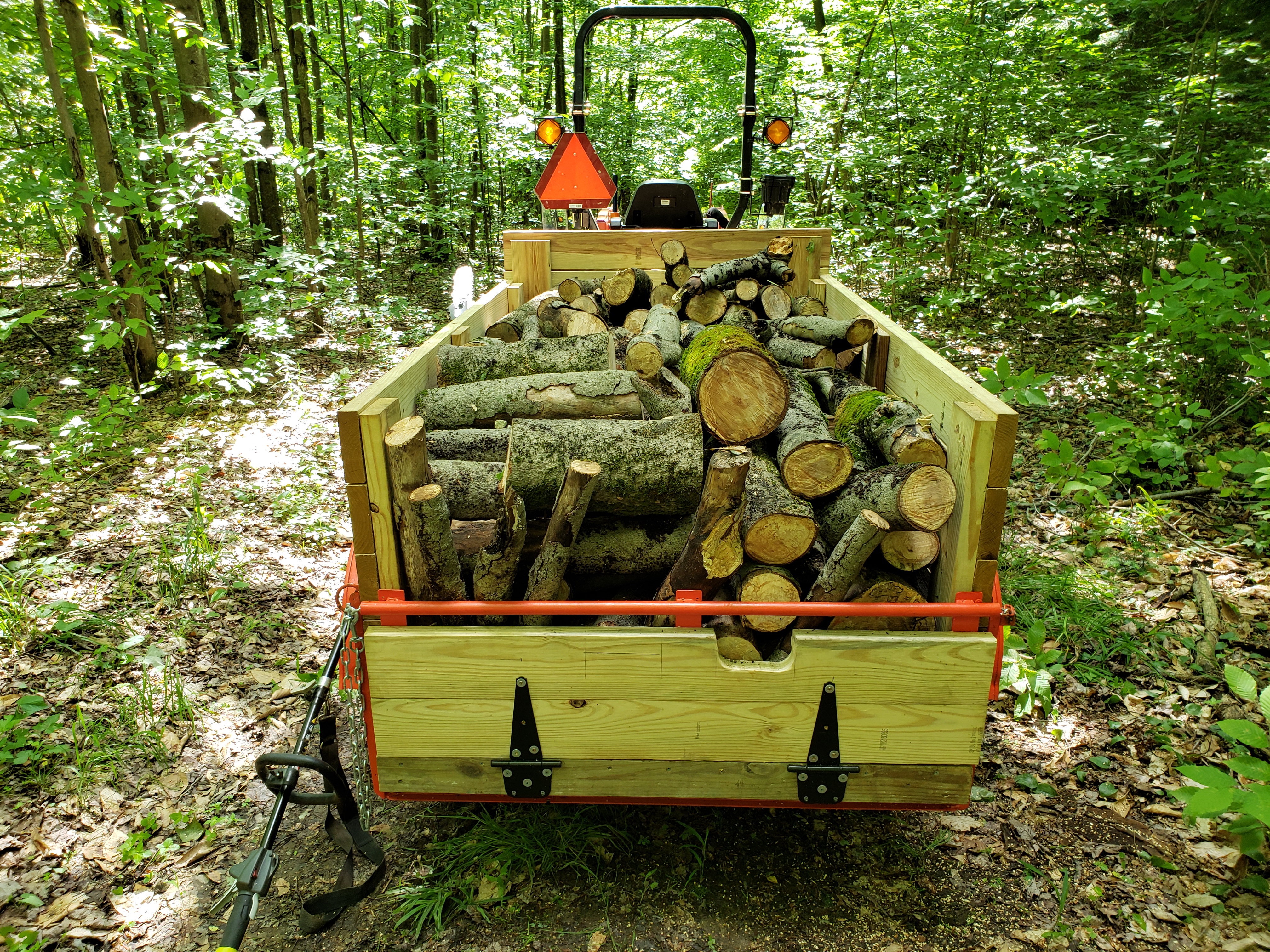

First load in the "new" wagon. Loaded it up pretty good, but didn't wanna pile it up too much for the first trip down the hill with it. Wasn't sure how the tractor would handle the weight, especially since it rained all night, and my trail does have a couple slick spots. Came down the hill in low range, 4wd, and my hand on the loader stick just in case. Had no problems, didn't even feel like I had a load pushing me.
And before anyone asks...(2 neighbors have asked about it already)... that cutout in the tailgate is a step when the gate is folded down. It does look kinda silly, but it sure makes it a lot easier getting in and out.
