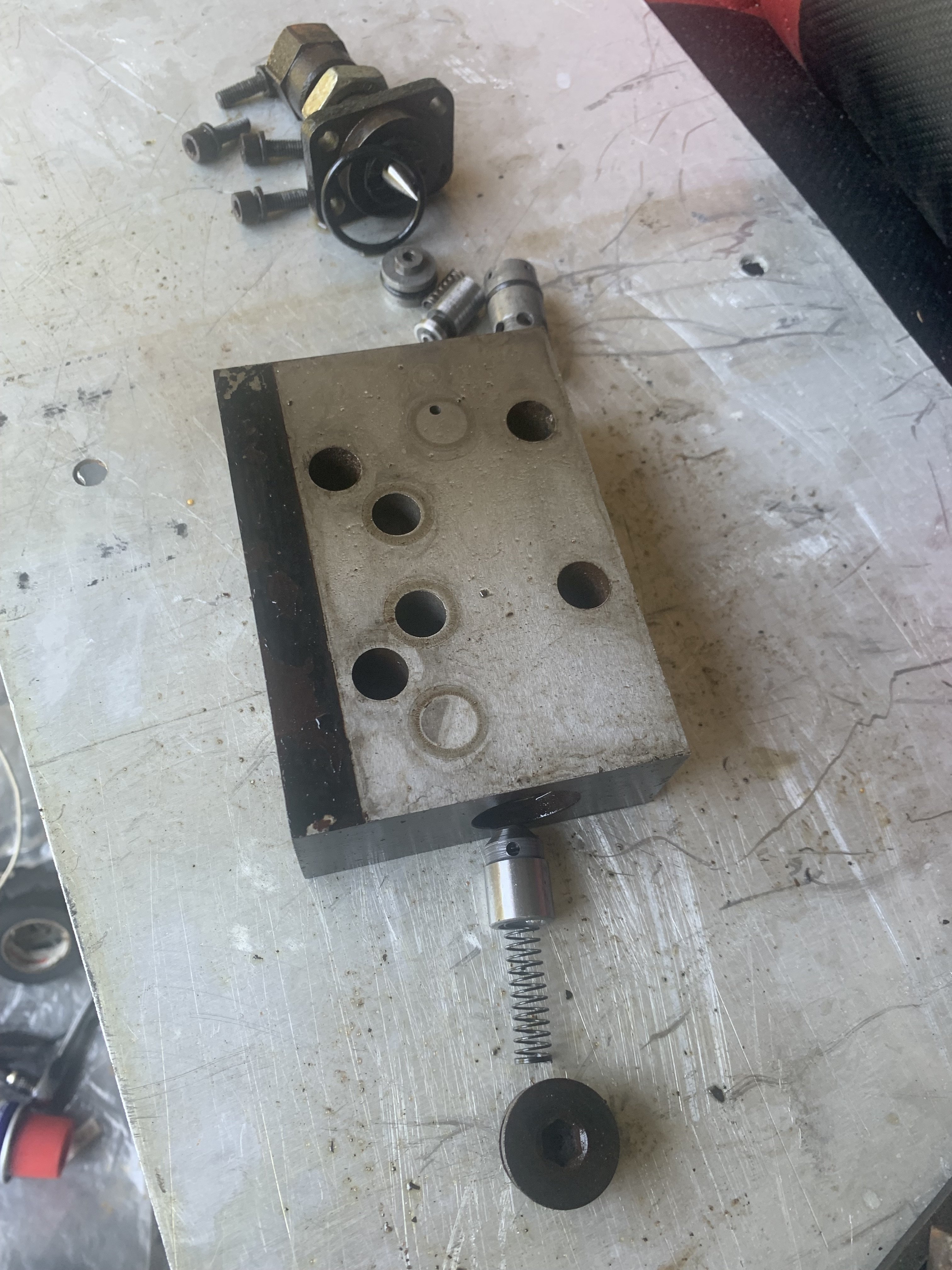

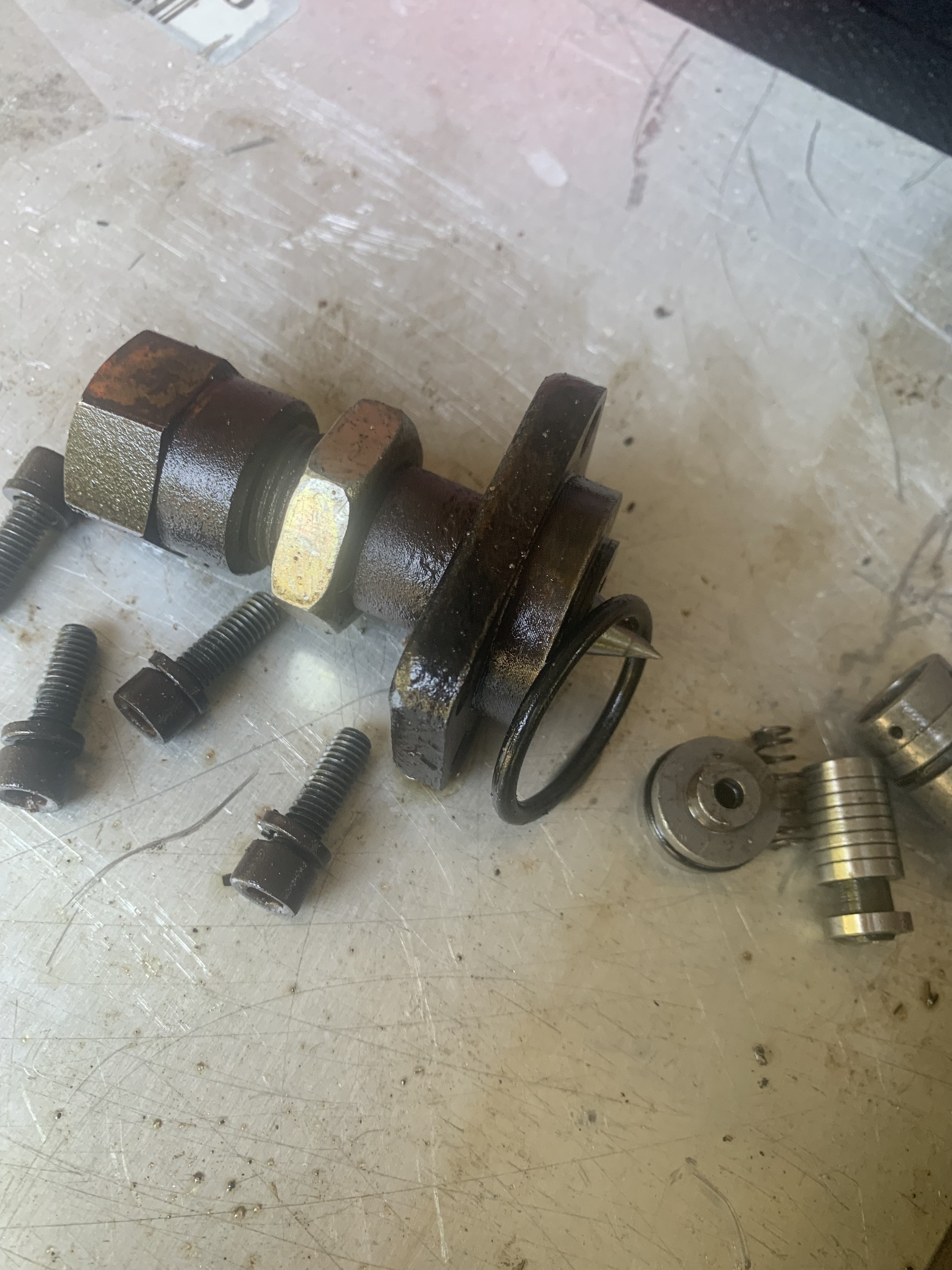

Where can I get the O Rings? I have a pressure gauge installed on the valve, how can I adjust the pressure? Is the big cap in the second photo the adjusting mechanism? Thanks for your help.
   / Ginma 304 backhoe problem #4
Not sure where you are located but there are O-ring kits available online. I suspect that those are metric sizes. Typically sizing is Inside Diameter and cross section (thickness) of O-ring. For regular hydraulic oil nitrile (Buna N) or Viton - FKM are both acceptable compound materials.
The cap may come off that adjustment stem but could be wrong on that.
That appears to be a pilot operated relief so make sure the small pilot orifice in the spool is open and that there is not contaminates on the seat or pilot pin.

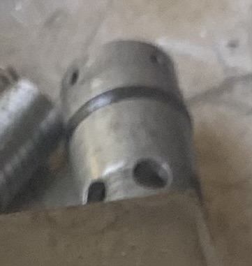

I got all the other O-rings, but there is a piston that has a flat groove ( see attached picture) and I am not able to find the right O ring. I even contacted CircleGTractors for the parts and did not get a reply back.
