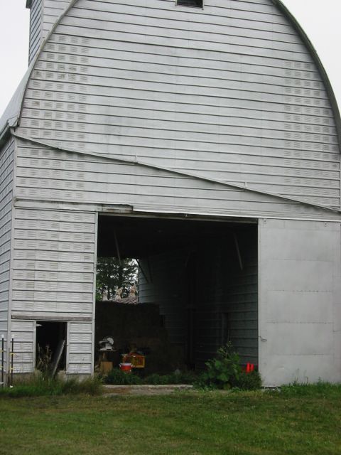

This ain't no wimpy bin. The walls are made of three inch douglas fir tounge and groove boards, and the floor joists are 3" x 16" in clusters of 2 joists every 16" on center.
Like I said, It is designed to hold a couple hundred thousand pounds of corn.
The aisle through the center of the corn crib is large enough to drive an 18 wheeler through.
Dave

The problem with unloading exists. I think that if there was no method of agitating the shavings, then some would fall out the bottom, and then the rest would sort of "lock" together, and not fall down the chute properly.
I dunno....I am still unsure if this is worth trying. /forums/images/graemlins/confused.gif
Dave
