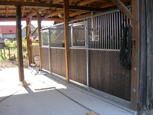

Now that i have a tractor with FEL and the manure loading onto big trailers is all of a sudden an easy job I start to dislike the fact that i have to clean the horseboxes itself by hand. I do have a FEL for something not?
Now the problem lays in the simple fact that a boxdoor is 1m wide and my tractor 1.25 m. hmmmm let me think
Here a picture when we were building our stable. Left and right 2 boxes and drive through from garden into paddock .
As you see the fronts of the boxes are galvanized panels with a sliding door. Weight about 250kg each.
As you also see a center beam is running from left to right side of the stable at ceiling height of 2.8 meter (temp supported with a beam in the picture)
Now if i would hinge the panels at the top and swing them up keeping them hanging horizontal over the aisle i would have 2.25m headroom and that is enough for the tractor to drive under.
Of course things will need to be beefed up enough to hold everything AND be safe. (a swinging 250kg panel would not be "open for argumentation" when it comes down)
Opening 2 opposite boxes at the same time would make maneuvering more easy.
So here we go. Pictures will follow with the progress and details how i did it.

About the barn, it was build after second world war, size is 10x12 meter (roughly 30x36ft) with the poles standing on rocks. My neighbor (left one on the picture is dated 1911. most people in the vilage had one like this but they were burned down during second WW. (village was pro german during the war and therefore not liked very much...) We put in a concrete floor of 1 foot thick (no foundations possible without dismantling the building / expensive high tech building techniques) and then put in the horseboxes. Basically nothing was changed to the original construction.
Every winter it holds 7 ton of hay on the top floor and it is not moving anymore. (had to re-locate 1 side about half meter to make it square again before putting the concrete) Wing doors were converted to sliding doors, just because they are more convenient with animals around.
We also made an extentension on both sides (garage/work place and straw storage) but kept the same style
