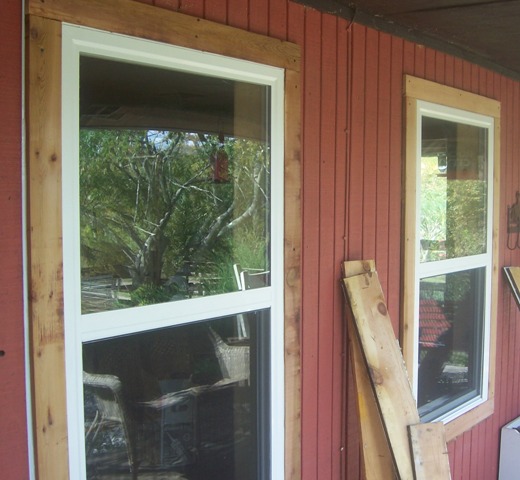

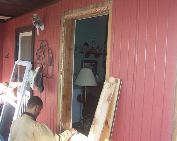

Well the house was built in '87 and for the past couple years we have talked about a few new windows and doors ... with it being wet and not able to get in the hay field today was the day.
First we removed the outside and inside trim as well as the side jambs, cut back the siding, got the old out and slid in the new ... insulated, chalked re-trimmed and chalked again ... we had 3 bad windows that we replaced and 2 out of the 5 doors needed replacing (didn't get both doors done.)
Monday I am going to blow in insulation in the attic ... adding 17" ... at present there is only about 6" ... just thought I would share this with you !!

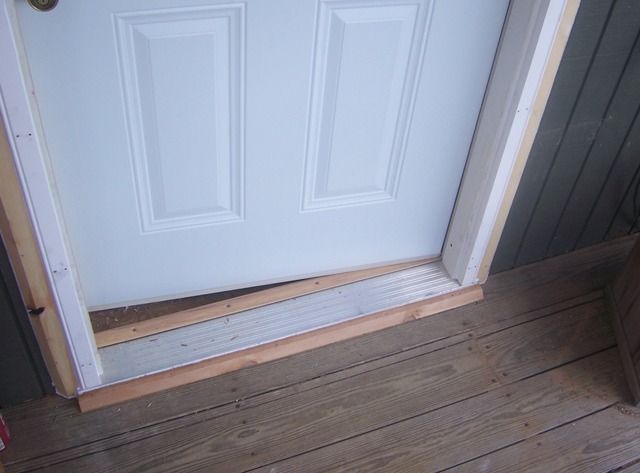

Thanks Dave ... I hate doors. They gotta be just right. May have to lift a corner, pull the top, twick the angle and most of all HOLD YOUR TONGUE JUST RIGHT!!!!!

That's pretty much my experience, you must have been watching. Sometimes, after about 20 shims, I take them all out and start over :(

Just as an FYI I thought I would mention that I noticed that you used "new construction" windows.
If you use "replacement windows" without the mounting flange it can save you a lot of messing around replacing trim and such. You can also save a lot of money on the windows themselves. I bought 11 custom built "replacement windows" built to the exact size of my origional windows for less money than stock sizes would have cost me at the big box stores. My 11 windows are double hung thermopane vinyl with the cross bars sandwitched between the glass with full length screens, double latches and swing in for cleaning from the inside. They were about $110 each.

OH SURE ... now you tell me that !! How is it ranchers are supposed to know that S**T ... why don't those so called professional sales people explain that??
he he....you are right, they should have told you. I wouldn't have known the difference either except I got lucky and noticed that some of the windows they had in the big store were "different" I investigated and started asking around and soon I knew more about windows than I ever wanted to know. The big box stores only stock standard sizes both in "new construction" and "replacement" and nothing in my house is standard so it saved me from buying the windows there. I found an Amish business that custom makes windows to the exact size about 40 miles from my house. If I could have bought standard sized windows I would have ended up doing the same thing you did but it would have been even more work because I have vinyl siding so I would have had to remove most of the siding from my house and put it back on.:mad::mad:
But you still did a good job and when those winter winds come howling out of the south west you are going to like the new windows. :D:D

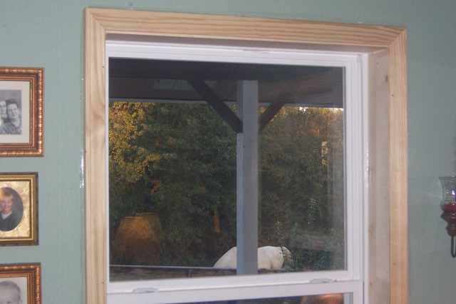

Am I reading these photos rite ?
These are the old vertical windows.
This is the new horizontal windows you replaced them with .

No LB the 2nd photo is the inside just zoomed in ... it looks wider !! They were replaced with the same size height and width.
