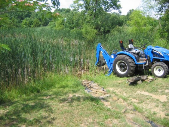

I purchased a BH with my new tractor with the intent of removing cattails. I've just started (I have two ponds to clean up), but it is working. With an 18" bucket, it is taking some time, but that isn't all bad /forums/images/graemlins/grin.gif!
The problem with pulling or cutting is that they just come back. Chemicals will work - Rodeo is the aquatic version of Roundup - but you still have the dead stalks to deal with.
My backhoe reach is just short of a few stalks and I will do those by hand. But I'm able to use the BH to get the roots up, along with a good amount of decomposed material. That is the real problem with cattails. They will eventually fill up a smal pond.
The down side to my approach is that I need more tools - a thumb would be great, but a dump trailer would be even better. Right now I am loading a small 4x8 trailer. I then pull it to my dump site with my litte Cub Lo-Boy. The load is really heavy and I have been using the BH to drag it out of the trailer /forums/images/graemlins/tongue.gif.
Good luck with your project.
