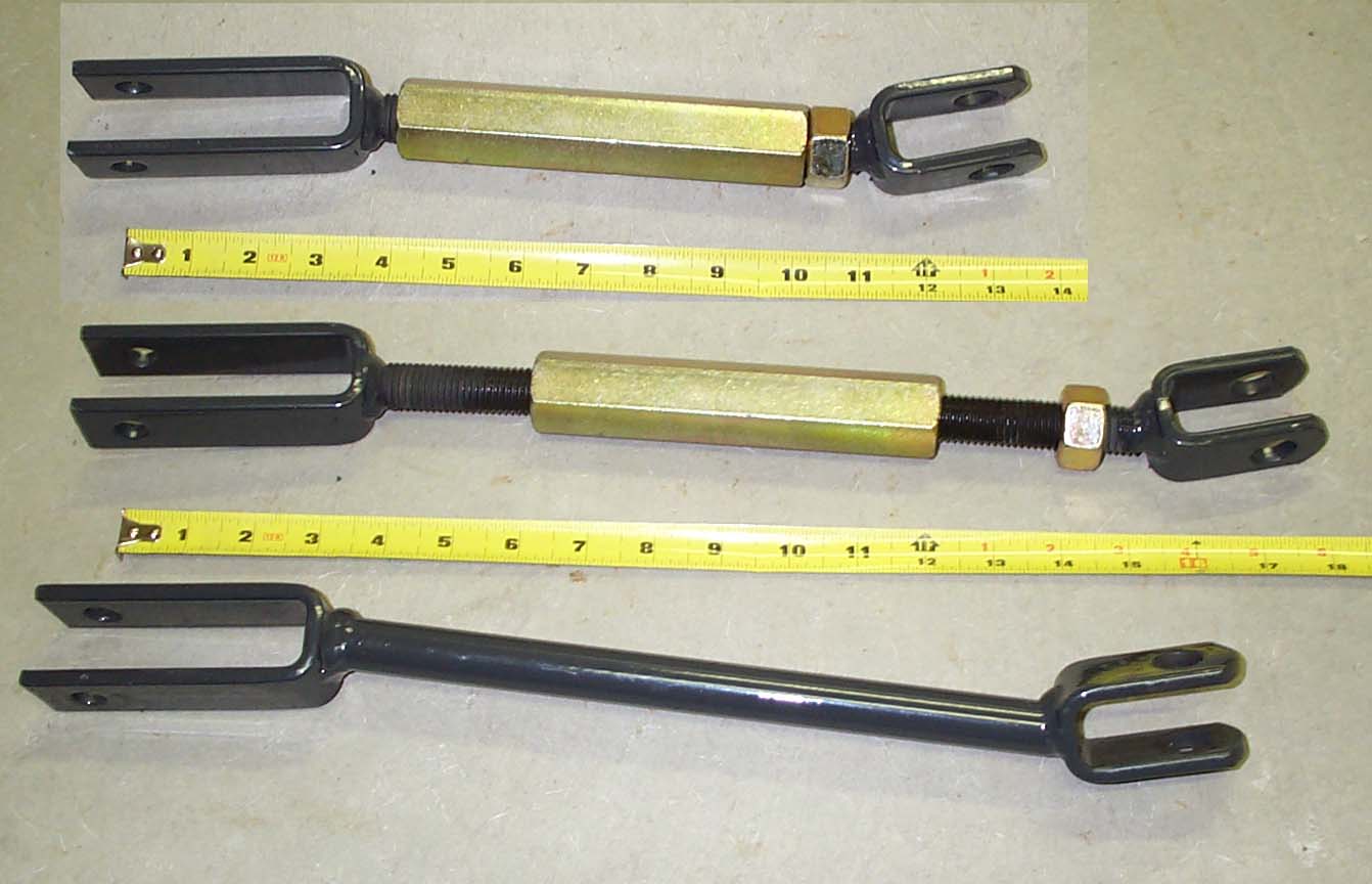

Kubota BX22
I had a problem with attaching a 3-pt fork to my BX22. The fixed left side lift rod would not drop low enough to allow the forks to lower to ground level. I bought a second adjustable lift rod ($25) to mount on the left side. This gives an additional +/- 2 inches of adjustment compared to the fixed rod. The adjustable rod is designed to go on the right side and has a bend at both the upper and lower attachment points. However, it appears to work fine on the left side as well. As an added bonus, the dual adjustable rods allow 3-pt attachments with high lift pin mounts to be lifted higher by shorting the lift rods.

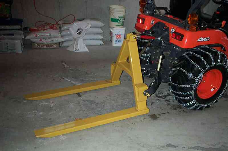

Here’s a view of the 3-pt forks lowered to ground level.

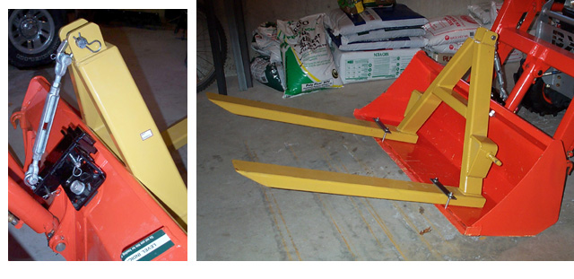

That looks great. You mind me asking the brand and price of your attatchment. I've thought about getting some clamp on forks for the FEL on my BX22 but I don't think the loader will be strong enough.
   / Getting more lift (drop) range on your BX
The forks came from ABC Groff (http://www.abcgroff.com/). They are MDS Model 1200. I have a setup to use them on the bucket for light duty lifting. They can handle at least 200 lbs in this configutation.
