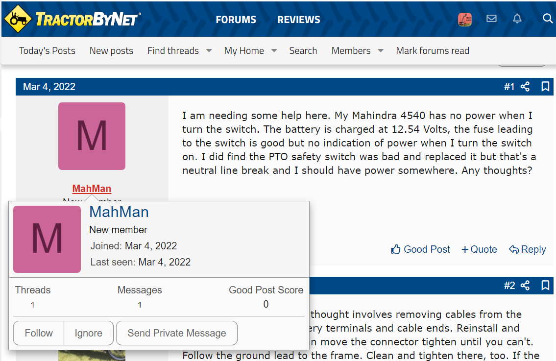

4540 Mahindra
I am needing some help here. My Mahindra 4540 has no power when I turn the switch. The battery is charged at 12.54 Volts, the fuse leading to the switch is good but no indication of power when I turn the switch on. I did find the PTO safety switch was bad and replaced it but that's a neutral line break and I should have power somewhere. Any thoughts?
