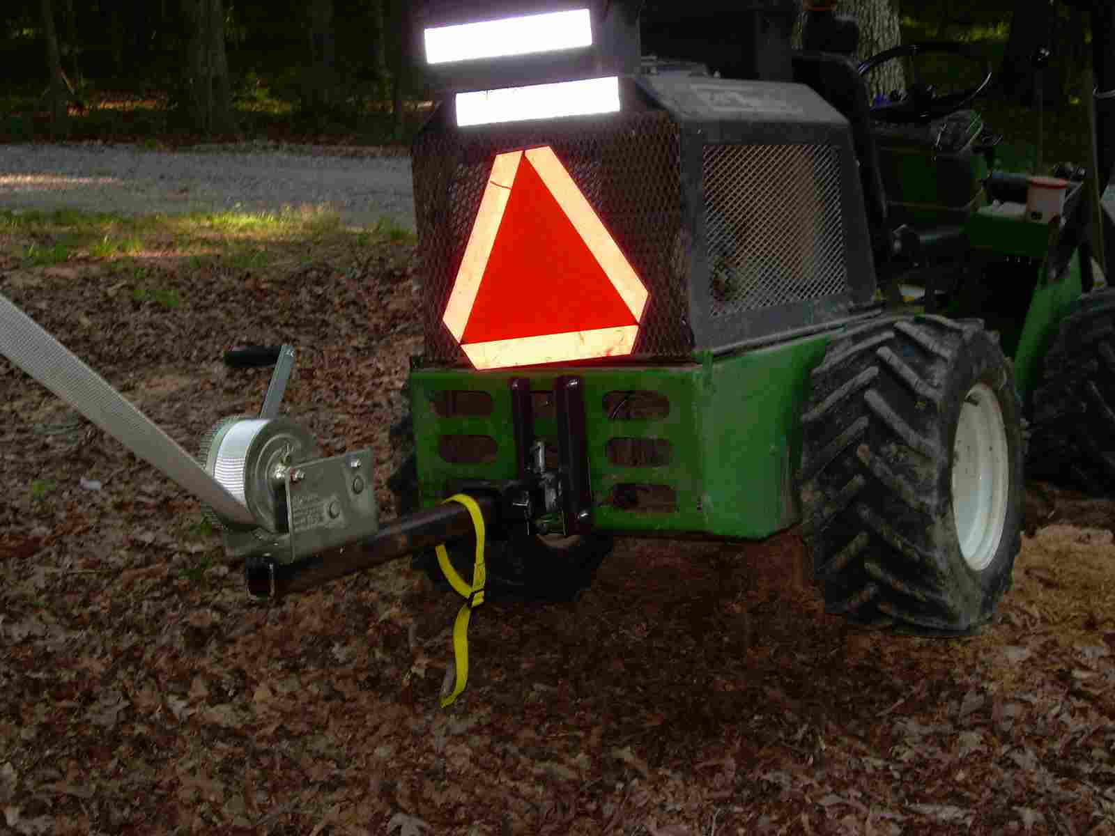

I have not seen a comprehensive thread on how owners get there PT unstuck. I would like to hear techniques that you use. I have a boat whinch on the back (see attachment) and have used the PT wiggle (steering left to right and back over and over while applying power to the wheels).
Maybe nobody else has got their PT stuck. There must be more swamps than mine.

Yup... I've used the "wiggle" to get out of deep mud several times. :D It's actually pretty difficult to get the PT stuck. Sometimes you can use the attachment (e.g. bucket or mini hoe) to help you manuver out of trouble. Once the body got stuck up on a pile of mud and dirt so the wheels couldn't grip no matter how much I articulated. I just pulled up my ATV and winched her out.
