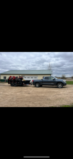

I've got a T394 tractor. I haul it in my 14' dump trailer, sometimes with attachments on. Towing with a Toyota tundra. Works well.

   / Getting a Dump Trailer to haul TYM 47HP a good idea
Interesting. You back in the tractor. is there a reason for that?
