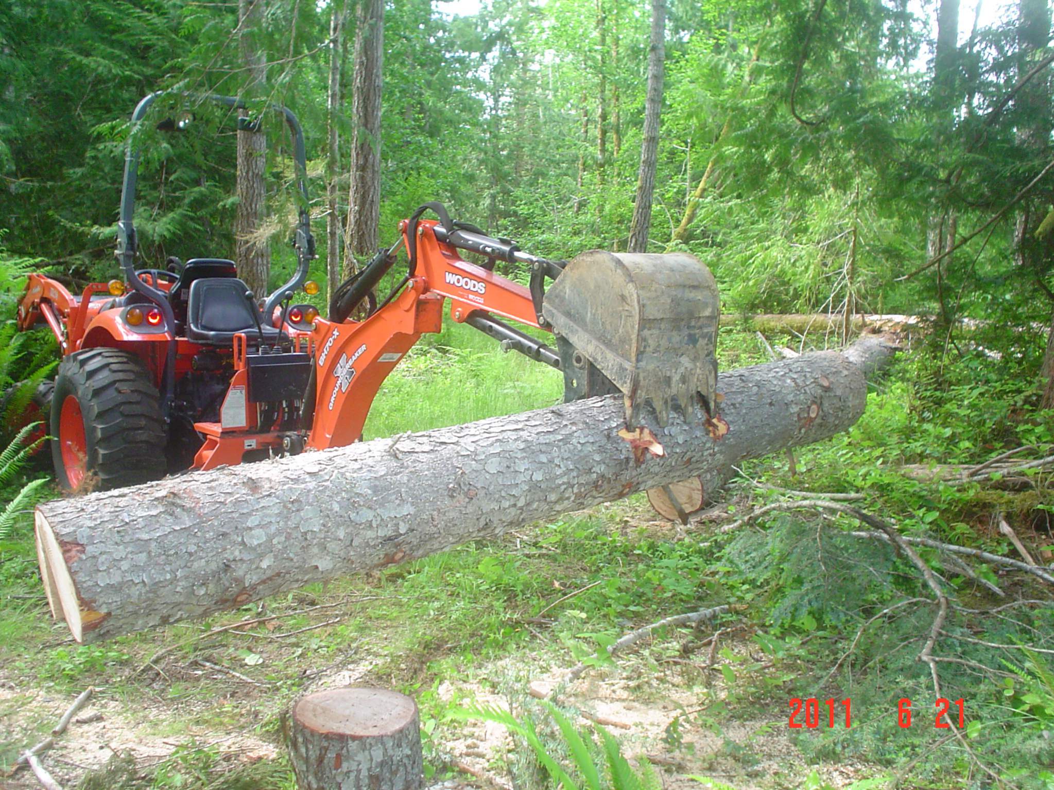

Thanks, Actually I did talk to them... They sell them on ebay and I got a quote for the 70x and the install package, but the shipping was the killer (to me in NY anyways). I think it was over $600 and it made having to install it and worry about the warranty with a DIY install seem like less of a good deal. I think we could do the install, which is why I got the quote, but it needs to be worthwhile and have less potential side effects. :D Risking the 2yr warranty to save a few hundred bucks was an issue; now a grand plus might have changed that but it wasn't enough savings vs risk with the killer shipping and having to install it. Actually I think the shipper should install it for $600+ :laughing:
The sub-frame is a killer for the CK20 too ($1435.00 :eek:), but I'm hoping that means it's built like a tank... It really seems to tie the tractor together with the sub-frame staying on and linking the whole underside, which also helps the loader transmit its forced throughout the whole tractor. The Woods sub-frame also keeps that weight on the tractor (and its mounted down low). So when the hoe is off so it should help some with ballast and keeping a low center of gravity too. It will still need more ballast, but it's not going to waste either by having it there.
The sub-frame on the BH6000 I saw was impressive and that hoe was smaller with pretty underwhelming specs (when compared to the 70x or 2465 anyways). It also preserved the ground clearance a lot (it stayed tucked up in, above the loader mounts lowest point) and that's an issue that lead me to the Woods over the Kioti and I hope that translates to the 70x's sub-frame too.

In the Woods book the sub-frame for the CK20 was around $1950.00 MSRP and even Rosseel's wanted $1435 for it. The total package would have been $400+chg or so cheaper, but I'd have to install it and I figured this way the dealer install won't create warranty issues.
If it was a bigger chunk of change I'd have gotten it through Rosseel's for sure; not that $400.00 isn't a good savings but we still don't have a concrete floor in the new barn and not installing a backhoe in my gravel drive seemed worth it! I've done enough transmissions and other under the vehicle work (on gravel) to never want to do that again... I also have disabilities that would mean whoever I have "helping" gets stuck doing most of the work. :(
I also think we got a reasonable deal because the dealers quote was made before they saw how much the sub-frame was for the CK20; it might have been more had they actually looked it up first. They didn't even think the 70x would work on the CK20, but thanks to tractorbynet and a few other sources I knew it would. I think the Woods sub-frames for other Kioti's are a good bit cheaper and they were going on that average price but I'm not sure. They may have just figured smaller tractor cheaper sub-frame. :thumbsup: They must have had enough profit padded to honor the quote so that's good in my case. I doubt they would have eaten the difference it if they weren't still making out OK.

  • I did get a thumb for the KB2465, from Michigan Iron Works, and it clamps on easily (no welding required). Somewhere around $350 with shipping.
  • Just learning to use the thumb, but it can sure pick up some heavy rocks that I cannot!
  • The KB2465 is heavy and hangs far off the back... going up what I consider a "medium slope" can make the front wheels rise off the ground :eek:... Not sure how Woods will compare, but something to watch the first time you drive up a slope. Alternatives: Go up backwards, or have something loaded in the front bucket, or go slower.
  • I got the 16" bucket, and if doing combined rock and dirt moving (as on my sandstone), I'm glad it's not any smaller... would have very little volume for dirt and broken rock, which I have to move while moving bigger rocks. Something you may wish to consider.
