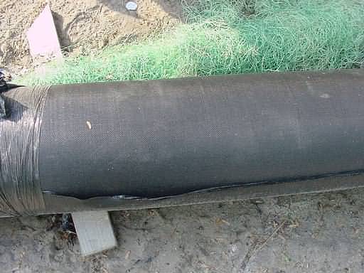

Here is a link to geotextiles and livestock. GEOTEXTILE AND LIVESTOCK
I've attached a picture of the woven geotextile that I use. Price is under a doller per running foot for a 12' wide roll. In this area it's well worth it under driveways or for skidding trails. Sorry but I can't help you on horse use. But a geotextile used correctly will really help in rutting so I guess that would speak for itself.
I would also look to see if your local rental centers, ag centers or even where your going to buy your limestone from sell any type of geotextile. Just a thought. Good luck

Gordon's picture is what I was referring to earlier. Sounds like it is priced about the same.
