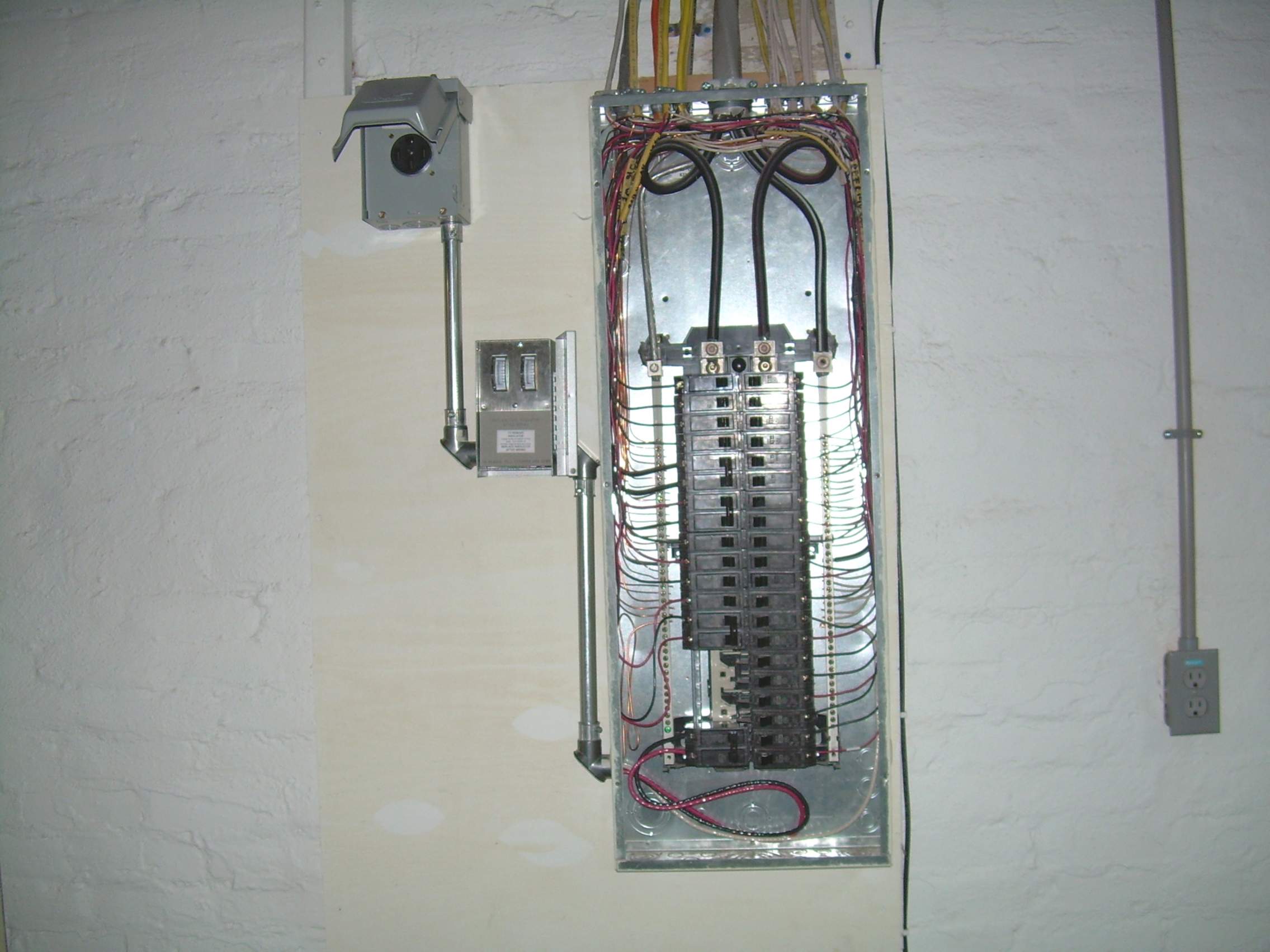

it's a little costly, and looks like your limited to just under 10 kw input which is fine for most people then there is the proprietary cord needed. the best thing about it is the ability to use any circuit in the house, not every one at the same time but still better IMO than just the set number on the multi circuit transfer switches.
I'd like to get the 200amp double pole switch where you can just switch between grid and gen, only problem is they are over a grand and are more than twice the size of a 200 amp breaker box.
   / generlink, anyone used one? #8
............... the best thing about it is the ability to use any circuit in the house, not every one at the same time but still better IMO than just the set number on the multi circuit transfer switches.
Good point. The interlock sets also allow every circuit to be used. Total input wattage is limited to how big of a circuit breaker you can fit in the "input" breaker position.
   / generlink, anyone used one? #9
Yup I really like the interlock idea and would do it, except I can't since I don't have a main breaker in the box, Even though I have a new 200 amp panel, it's considered a remote box being more than x number of feet from the meter, only have a main at the meter.
JB
JB
So for you to use your 50Amp hook up, do you have to go down and turn off the main breaker, otherwise it would back feed it illegally, right?
