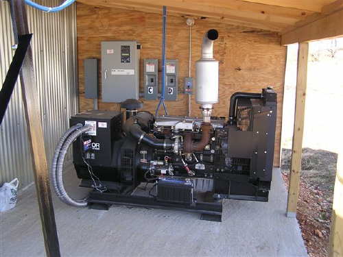

One thing about an LP setup, the fuel would never go bad and you wouldn't have to worry about water in the fuel.
I have a diesel setup for my poultry farm. The gen set exercises every Monday at 8 am. This is an option you want to be sure and get, regardless of which fuel you decide on.
