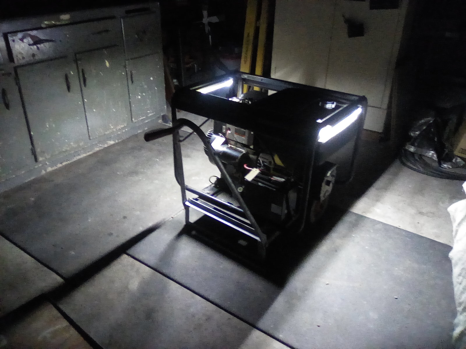

Some may think I'm a little nuts but I added a set of lights to my generator.
I was tired trying to find a flashlight to go out in the dark with no electricity to start the generator. Doesn't happen often but once is enough. Found some 13" strip lights on Amazon for $11. Each have their own switch. They work great. You can see exactly what you want to do. Kinda surprised the new generators don't offer this. Of course you need a 12v battery. Some pictures. These were taken at nite in the garage..

You may have better luck, but I found the cheap Chineseum strip LEDs from JeffCo to be of less than reasonable quality. Nearly every one I got failed within a few months of casual use. The ones at local auto parts stores are far more reliable.
I added a power out circuit with an 110VAC relay. Power goes out, DC lights come on so I can see the generator panel.
