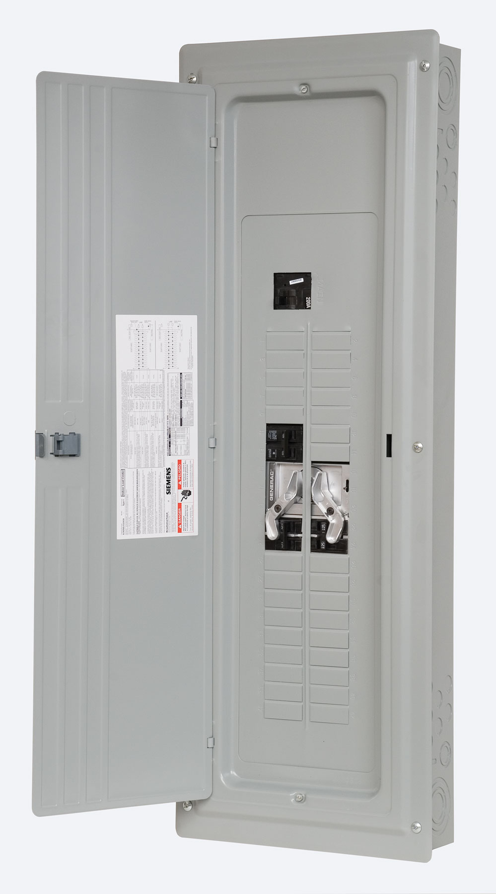

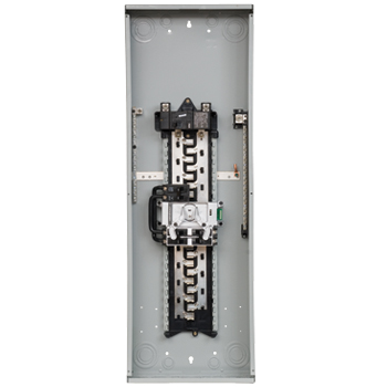

When i come onto jobs that want to use a 50 amp generator on an existing 200 amp service, i generally have to add a generator panel right next to and interconnected with the main panel. Then i physically move the circuits that i want the generator to power up (up to 50 amps max continuous load). This panel will have a simple manual interconnect switch that will simultaneously disconnect the generator and the utility power so both cannot ever run at the same time. I then run a #6 copper line to an outdoor generator ready receptacle. The owner only needs to move the generator over to this outlet and plug it in. Then switch over the panel manually.
They also make replacement main panels that have provisions for either an automatic or a manual transfer switch. These panels have a split bus and are 100% legal for generator. I have used alot of these for retrofits for houses with undersized generators, especially where there is no room for another panel. I LOVE them. few hours work and its up and running.
I use the Siemens panel. It has a provision to be easily changed to a fully automatic system in the future if the owner upgrades his generator.
