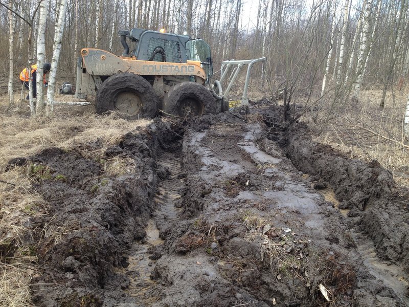

photo of our loader, mulcher on Mustang 4000v (gehl), in Texas is warmer than in Russia, it is better to install an additional oil cooler, in general a good machine

Very mean bada$$ looking machine sir! Did you leave your 4000V unattended in the forest during lunch and your Prentice 2864 had his way with her, producing that? If The Dakar ever opens a skid steer category, you should consider entering it. I bet it would beat Eduard Nikolaev's Kamaz. :cool2:
Seriously, what wheels and tires did you put on that? Are they foam filled? Did it need spacers? How wide is it wearing those tires? What is the resulting ground clearance? How does it do in mud and muck? One of the major reasons I keep considering getting a Terex PT110 Forestry is because of it's awesome best-in-class ground clearance (and flotation). And just wire undercarriage maintenance costs into our rates. Anyone have any thoughts on that? How important is ground clearance in your CTL/MTL/skid steer mulching purchase decision making? Looks like very important to harwest.
About the add-on hydraulics cooler idea for mulching with a V400 or a 4000V, any idea how to do that? Who makes a cooler that would work? Is anyone already doing that? If so, what should I look out for?

wheels with air, two options 16.9-24, 14.9-24, special order, clearance 350-380mm
   / Gehl V400 opinions? #8
standard loaders Terex is better patency. I had thoughts to put tracks on 4000v with big wheels, that would be fantastic
