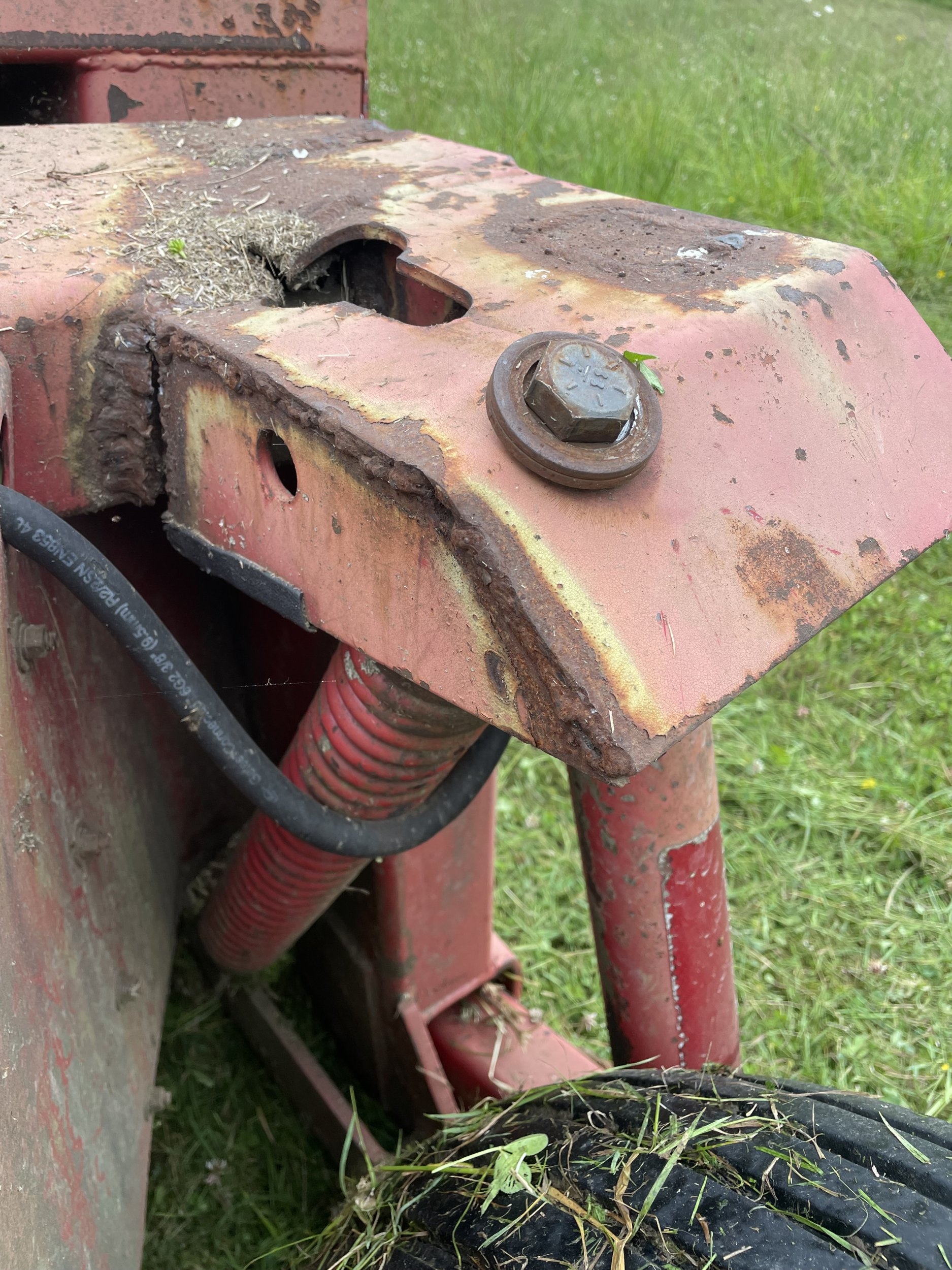

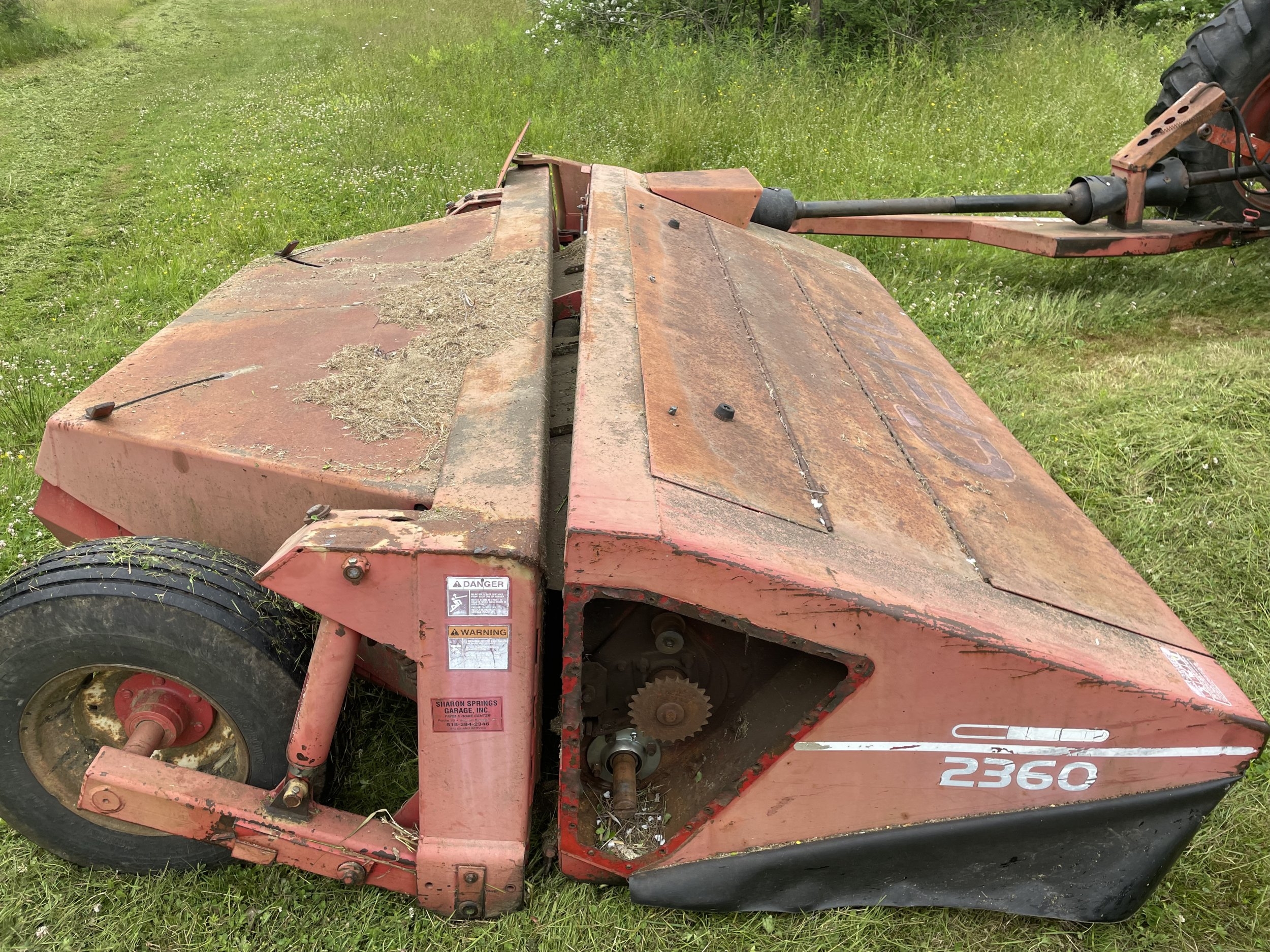

Looking for some advice on repairing this discbine. I think the frame is twisted and the spring tower definitely needs some welding. I don’t think this gap which is wider on the far side and narrower on the side closer to the camera is a normal thing and is a result of somebody probably hitting something hard in the field at some point. I was thinking about chaining the top corner of the frame to a tree, and then pulling the bottom corner with a winch to adjust the frame back to what would be closer to normal. On welding the support I’m not sure if I should just bang it back into place and then weld it or if I should cut it off entirely and rebuild the whole thing from the ground up. Appreciate any advice and suggestions on how to fix this. Anyone run into this before? On a Gehl?
Thanks,
Josh
   / Gehl 2360 frame repair #2
Seeing that it has been welded before and failed, it probably need to go into shop, old welds ground down, panels brought into alignment and rewelded and then a gusset plate or over lay of more metal to reinforce the repair.... Needs serious attention if implement has great value to you....
   / Gehl 2360 frame repair #3
Looks like the axle mount is being forced up. Needs to be repaired where-ever the stress is in mind.
   / Gehl 2360 frame repair #4
Unless it has some sort of intrinsic value to you, if it was me, I'd off it and buy a newer one. Discbines if working correctly and the header tension set correctly, all float over objects in the field unless the operator is a dork.
