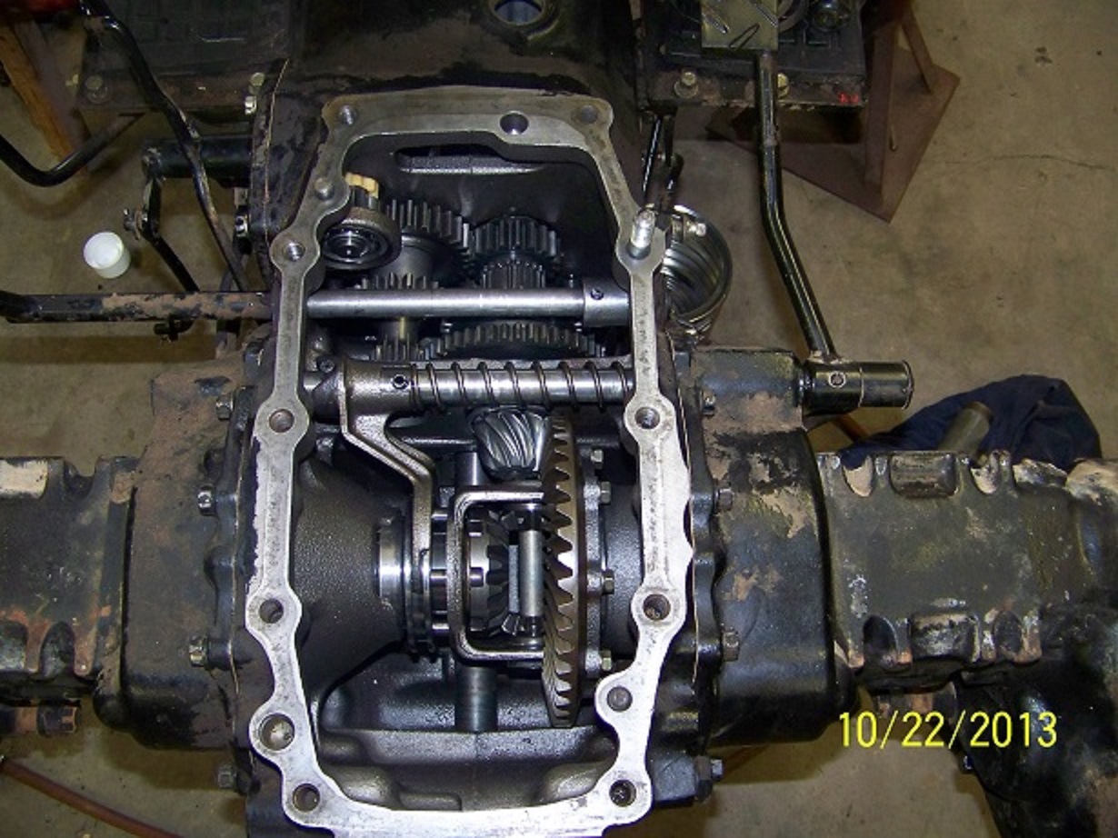

Oiling the shaft won't do much. I think there is a watertight o-ring as the first thing inside. (These are designed to run half-submerged in a rice paddy). The parts that engage to lock the two axles together are likely bound up with rust if they don't disengage easily. Simply using the tractor more with the diff lock engaged sometimes, should work those parts loose.

Here is a picture of the mechanism in a an FX24D. Not the same as your 2210 but operates the same and as you can see, very plain to see. You can see how the shift arm cam is moved by the roll pin in the shaft. I agree with California, non use and age likely contribute to the binding.
